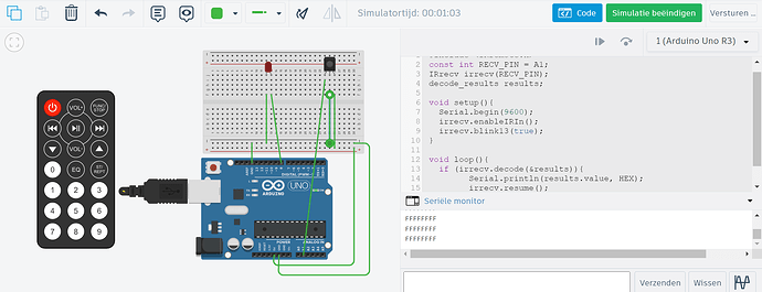

I recelntly started trying with the IR-receiver but it doesn't work really well
so i tried this code with my irl irreceiver but i only got F00000 back and now i tried it on tinkercad but it's the same thing. i've followed two separate tutorials and both didn't work. any idea what i'm doing wrong? The irremote library is working as far as i know. i've tried to pput the signal pin in analog and digital already.

are you using an UNO R4 Minima or a plain old Uno R3?
the IRremote library has gone through extensive changes, not sure which version is used with tinkercad versus the one you could have on your computer.

tinkercad uses the uno R3

So what’s the issue ? That the simulation does not work or that your real world system does not work?
Use the latest library version and the example ReceiveDemo and you will be lucky!
With the latest version of the library try this code with the serial monitor opened at 115200 bauds

it worked! thanks!
