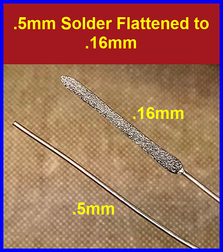

You can effectively flatten solder to achieve more control over soldering skills.
Etc. . . .
