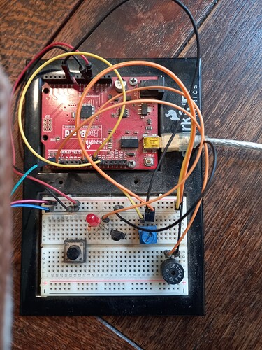

All Uno/Mega starterkits come with a breadboard. Below my 9yr old SparkFun (SIK), my vebnture into Arduino.
The breadboard is glued on the black holder with double-sided tape, the Redboard is screwed in the black holder.
Not sure if a black holder comes with the Mega starterkits.
