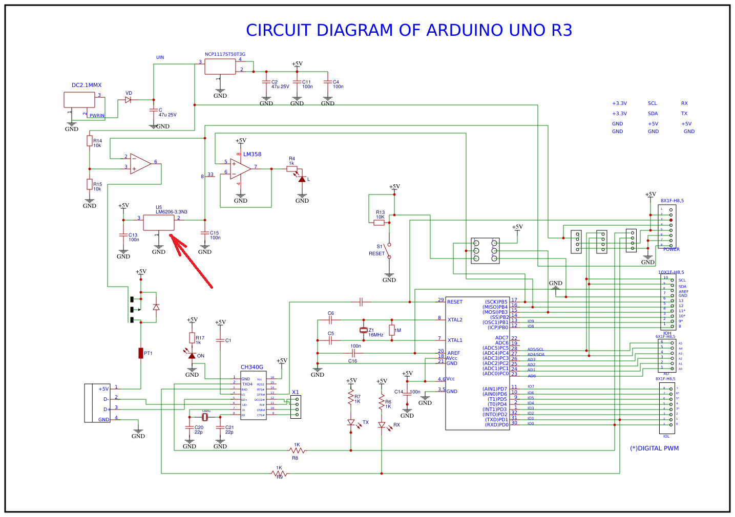

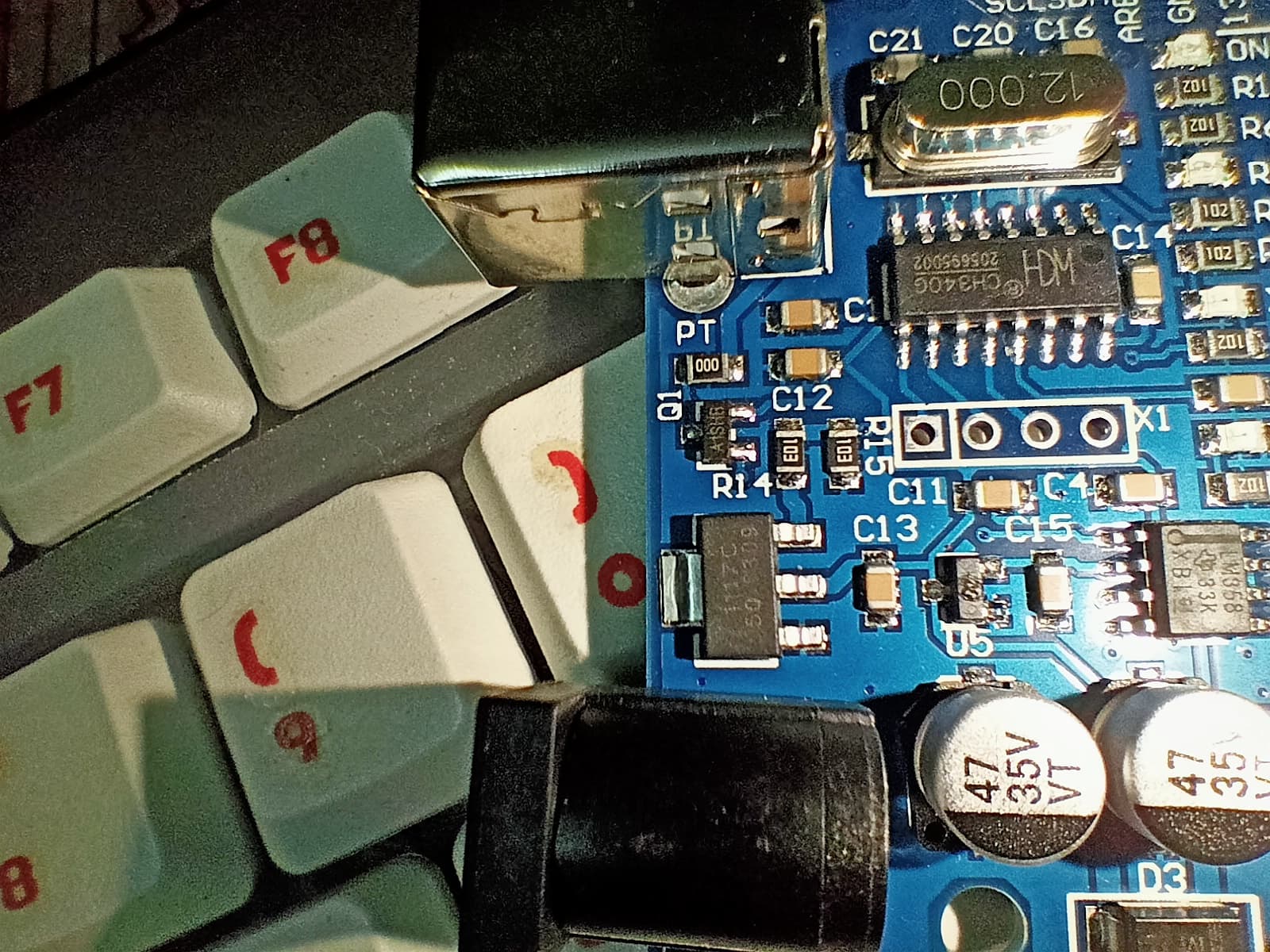

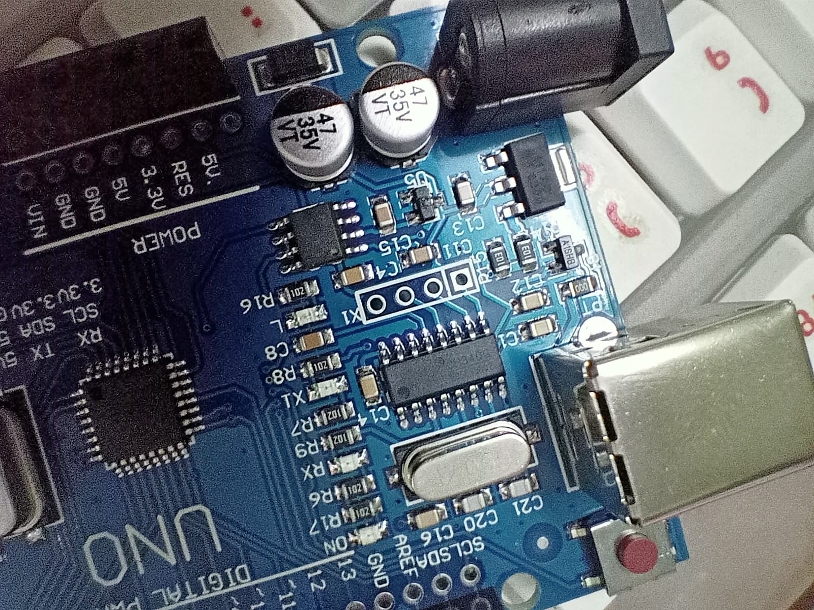

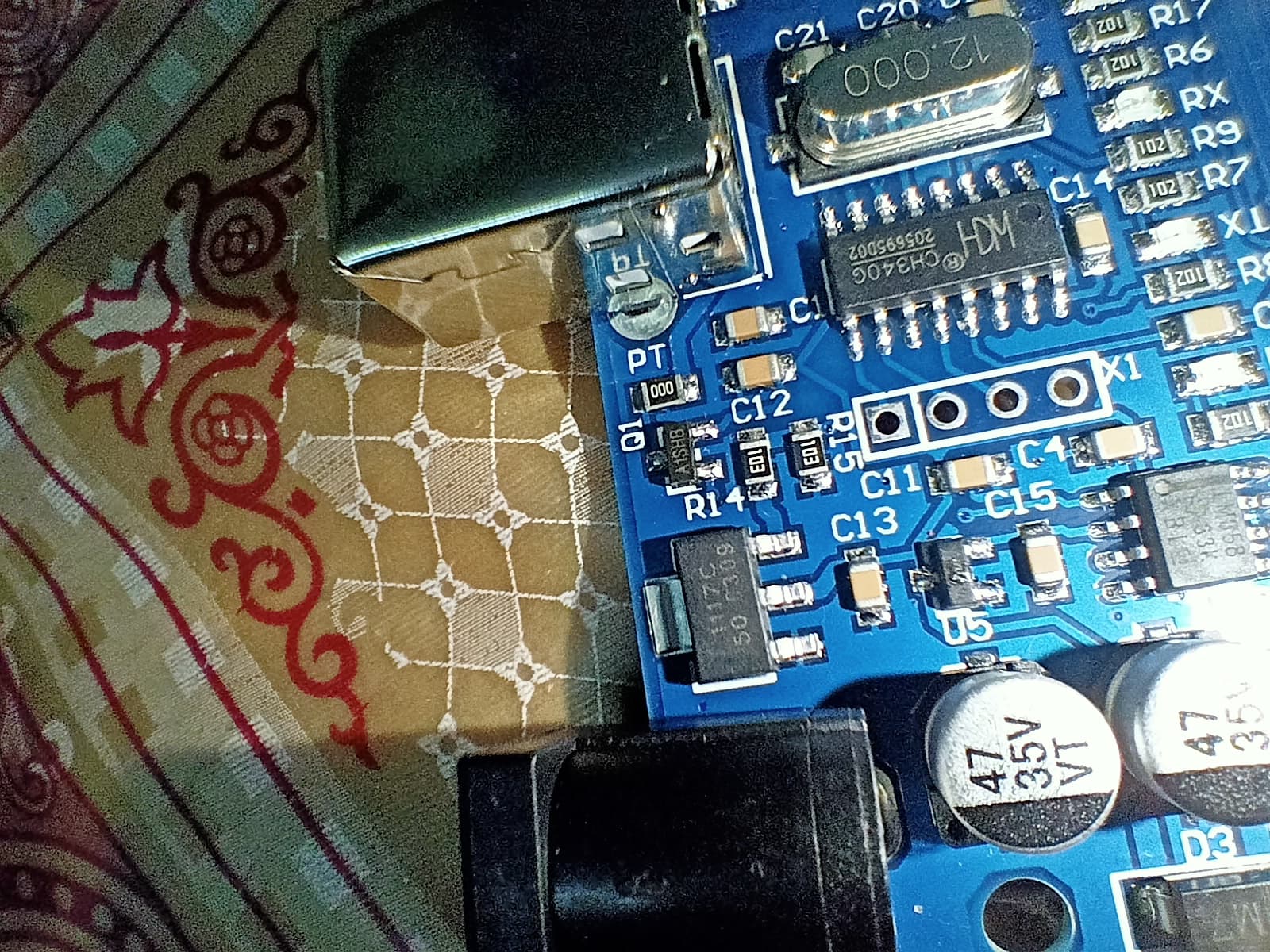

So I was tryna learn push button on my uno r3 (cheap clone) and i somehow ended up connecting the 3.3V pin to both ground and an input pin (pin 2) at the same time (Might've also disconnected and reconnected the input pin multiple times) . Very soon, I hear a spark and see smoke coming from the board ("magic smoke" or so I've heard). So I disconnect the usb and this "U5" component seems to be disfigured a bit. Now if I plug the usb back in, this region gets heated up quickly enough to burn my finger. Is my board salvageable by any means or do I require a new board?
Photo of thing that got hot?
Which one?
One in the middle?
Or near the USB port?
I noticed that the crystal on that clone is a 12MHz one. The standard crystal should be a 16MHz one.
So when you get a new one get one with a good crystal otherwise you will have trouble selecting baud rates for serial communications when you get further with your adventures in Arduino land.
That 12 MHz is for the CH340.

If you mean U5, then you could desolder it and see if the board still works.
If you have a pair of small wire cutters, you could try cutting it off.

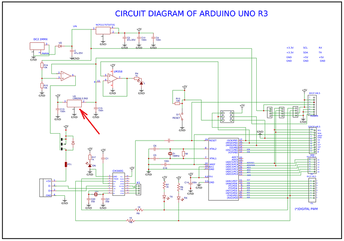

The blown part is the 3.3volt regulator.
It's only used by the Uno for switching off USB supply when on external power.
If you only use the Uno on USB power, then it should still work normally.
The 3.3volt pin is not used in most projects.

Its the U5 that seems blown and it gets really hot when i plug it into the USB port
So the blown part still gets hot?
Crush the plastic part with something (screwdriver, pliers).

It's the 3.3V regulator.
There is a chance it may still work but you won't have 3.3V output anymore
So i can just replace it? Thanks a lot
So i can still use the board but that component gets hella hot, so do i remove it?
