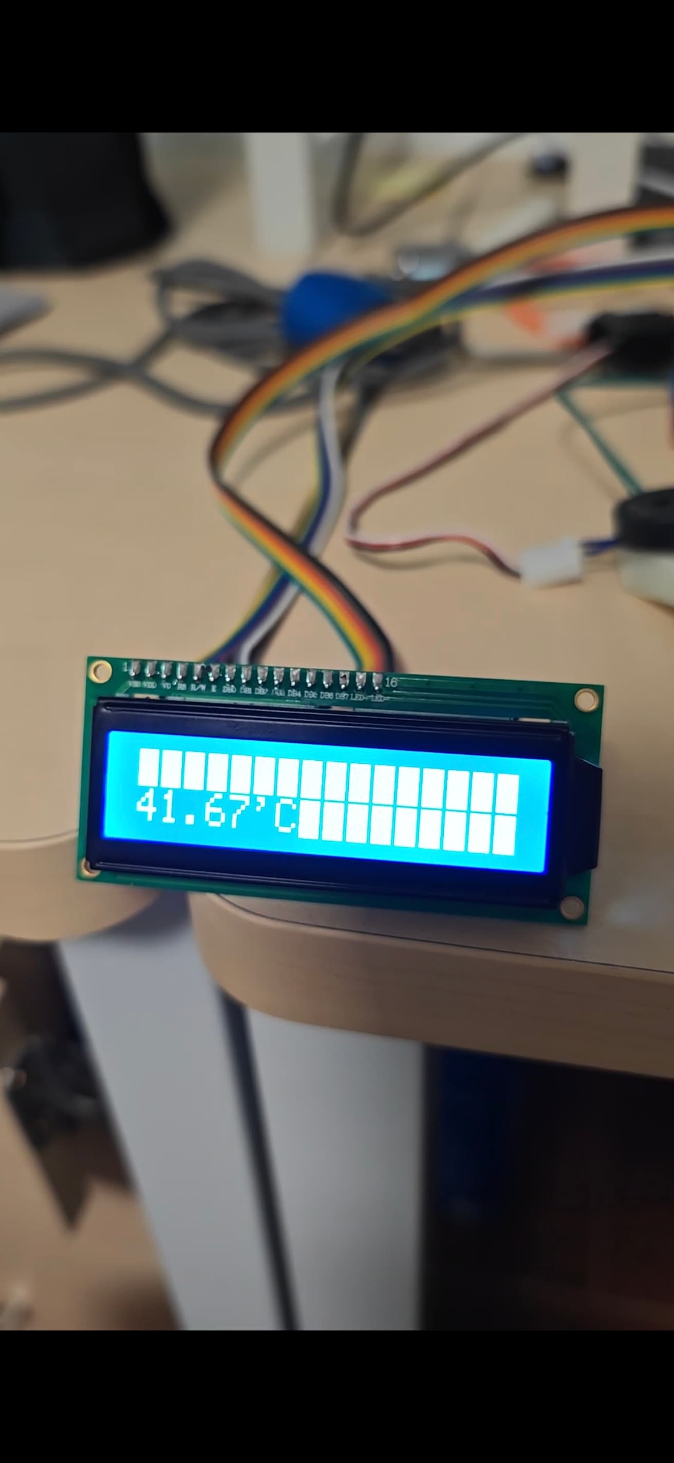

I try to use IOT CLOUD to make a greenhouse temperature monitoring system, but there are some errors
Hi there,I am new to here , may make some mistakes ,thank you for the help!!
The device can automatically detect the room temperature and upload the data to the cloud,when temperature is too high, the red light will be on, the buzzer will work .
All code can run without error locally but it will have errors on IOT Cloud platform.It can see real-time temperature ,but when temperature too high the every device will work correctly 5 seconds,and then every devices go down. Here is the situation of the screen when error occure.
here is the Cloud Variables
Snipaste_2023-11-26_22-34-43
thank you for help!!!!!!!

and this is the dashboard.
I have found the reason ,there are something wrong on buzzer,I'm working on it now
I finally find out that there maybe something wrong happen when one loop has more than 8300ms delay.I’m now finding other function to replace it.
Hi, you should avoid using delay in the loop function when connecting to the IoT Cloud, because this can interfere with the synchronization between the Cloud and your board.
You could try to follow this suggestion, which explains why you should avoid delay and gives a clear example of how to replace delay with millis:
thanks
hello,thank you for the reply , I use this method on a demo to tese the feasibility,but after i uplode there has something wrong,the red LEDs always flash at a frequency of 4 long and 4 short flashes and the buzzer dosen't sound.......and i can't connect to this board anymore unless I reset it. But this demo can work correctly on UNO R3 :thinking:
