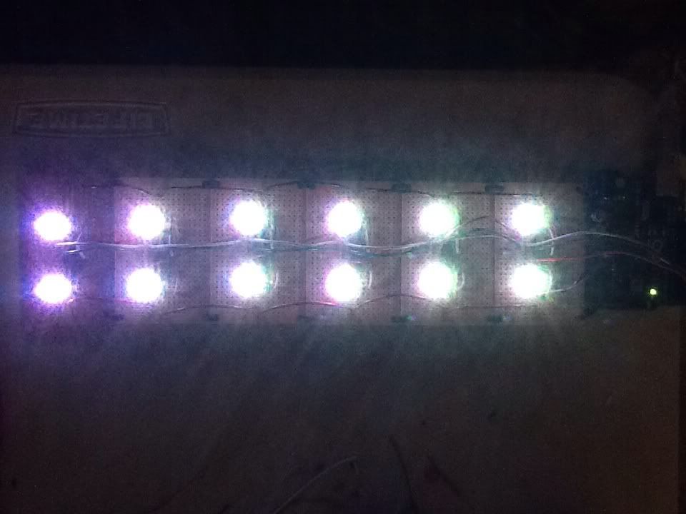

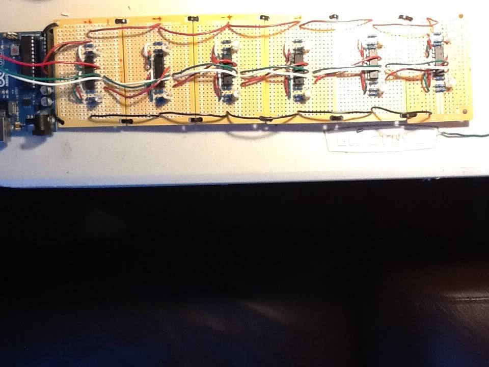

i want to connect 10+ shift registers together with 2 rgb leds
im not exactly sure what im doing... but some how i can get all the leds to turn on. by altering some code i found when i google " shift registers arduino"

I don't see any decoupling capacitors on that circuit so it will not be stable.

this is a prototype once i master the code im gunna surface mount everything to minimize space. then i will buy and add the cap's.

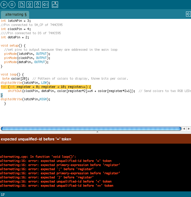

so this code goes in the void loop part right?
this is what i have so far....
im so nub! dont make fun hahahah
having some problems/errors
Your variable called 'register' is one of the words you can't use as it is used in the system. Replace it with 'myregister' or some other none reserved word.
