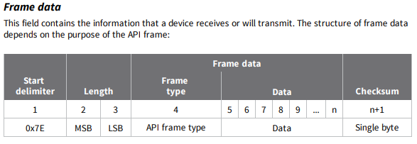

ok this is the Format of my Frame.
I have the XCTU software, there i can make frames in API mode.
So a made de Frame like this:
So I take the generate frame :
7E 00 27 10 01 00 13 A2 00 41 4E F1 24 FF FE 00 00 58 58 2E 58 58 20 30 30 3A 31 31 3A 34 36 20 30 31 2F 30 35 2F 32 30 32 31 41
And copy in my program to transmit but the program dont run when use : ... 7E 00 27 10 .... only when I add 0x7E, 0x00, 0x......
And ok yes, I accept that I dont pretty smart programing.
I see what happens, and I sorry becuase the program run when I use {127, 0, 53, 16, 1, 0};
So i Need to convert : 7E 00 27 10 01 00 13 A2 00 41 4E F1 24 FF FE 00 00 58 58 2E 58 58 20 30 30 3A 31 31 3A 34 36 20 30 31 2F 30 35 2F 32 30 32 31 41
I decimal values, and put in packet[] array to send .
there are several things in the packet that must be correct for the packet to even be accepted by the receiver -- the first 4 bytes and the last byte.
the first byte must be 0x7e and the the next two bytes must be the length of the packet (presumably this include the header bytes and checksum, but not sure). i don't know how many Frame Types there are or what they are. And the final checksum byte needs to match the preceding data.
the packet will not be accepted if these bytes are not correct -- wrong number of bytes in the packet or incorrect checksum
even if the packet length remains fixed, the checksum must be recalculated for each new packet
I understand that of course, what happens is that since I know that my data has this structure (XX.XX 00:11:46 05/01/2021) 25bytes and they will not change, because they will always be those. XX.XX is a voltage value that I am going to take the ADC, but hey that is another matter. What I mean is that the data sizes will not vary, that's why I see the frame header as a constant that will not vary, the delimiter bit, the length of the frame, the type of frame it is for transmit and the address of the node to which I am going to send the data frame.
On the other hand, if I am aware that the checksum does vary, because each time the frame is sent, the seconds are often, the minutes also therefore the checksum will vary.
I would love to know how I can do that operation to get the checksum.
as the note you posted describes
unsigned char
checksum (
    byte *pkt,
    int   size )
    unsigned char sum = 0;
    for (int i = 3; i < size-1; i++)
        sum += pkt [i];
    return 0xff - sum;
