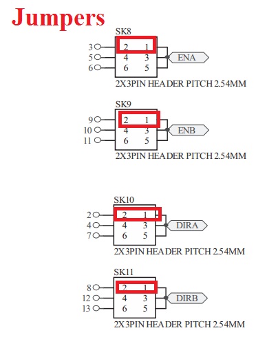

I now see that your shield has hardwired inputs to always be different (DIRA = !DIRA2).
They then use the enable line to turn coil on/off (possible with PWM to DC-motors)
There is no current control, so even its possible to use your shield, it is be not very smart as the motor will get very hot.

I have the code changed a little..
Set jumpers to match picture.
Code may be changed to add a 'relax' key where enable-lines are set low. (to stop current flowing)
Your motor will get hot. Abort before reaching 70 degs.
