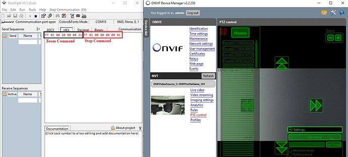

I would like to measure the time of command
Hi there, Hope you all are well.
I am building a PTZ Camera through Pelco D for which I need to do speed variation with respest to zoom.
The only way, I am thinking of is to measure the time, the serial data for zoom command is coming.
When ever I click for zoom, this command "FF 01 00 20 00 00 21" for 3.5 sec ( 1x to 26x zoom) followed by stop command "FF 01 00 00 00 00 01" when I release the zoom button.
How can I measure the time of my zoom command.
The reference code is as under.
BOB-TMC-5041 - Zoom.zip (3.0 KB)
Make a note of the time (millis) when you get the zoom command and also when you get the stop command. The difference is your duration in ms
In addition to "software" method, introduced by @J-M-L , I can suggest a "hardwire" one.
Choose any free pin, in the first command apply a high level to it, in the second low - and see the pulse on an oscilloscope or logic analyzer. This method is good because it does not require a monitor and can measure durations in fractions of a microsecond.
It requires an oscilloscope which is less frequent in the tinkerer kits :slight_smile:
that's why I say that my method is only addition to yours :slight_smile:
I have implemented something similar to it. It is working now. Thanks alot
Thanks alot. Let me check into it. I have implemented the method mentioned by @J-M-L ... It is working for my application. Thanks alot
