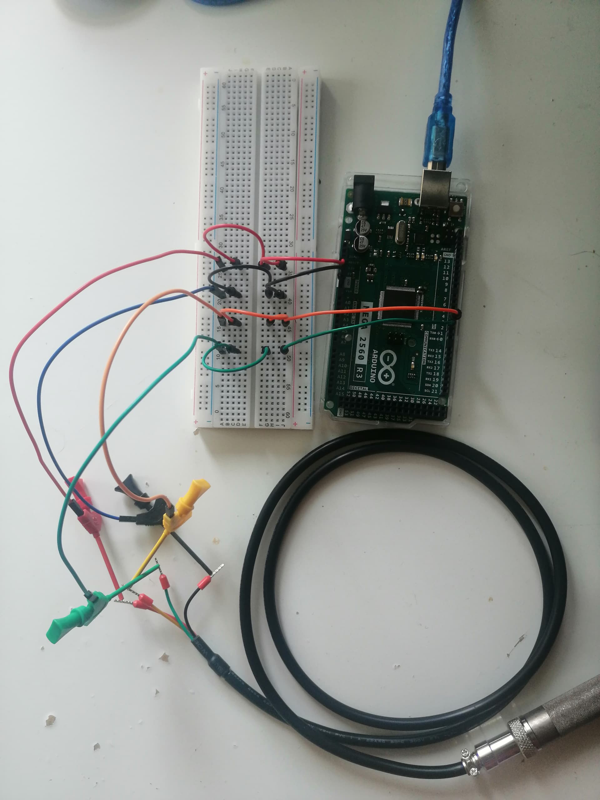

Welcome to the forum.
Can you show a photo with the Arduino board, the prototype shield, the sensor module and the wiring ?
Can you give a link to your prototype shield ? Is it a shield for an Arduino Uno without the SDA and SCL pins near the AREF pin ?

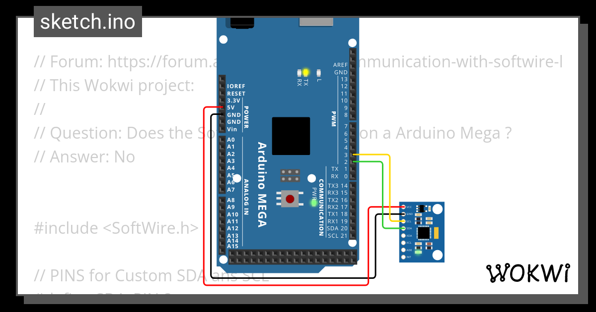

Instead of trying to communicate with the sensor, it is easier to run a I2C Scanner.
Can you try this:
// Forum: https://forum.arduino.cc/t/i2c-communication-with-softwire-library/1237721
// This Wokwi project: https://wokwi.com/projects/392870739462268929
// Question: Does the SoftWire library work on a Arduino Mega ?
// Answer: Yes, I think it does.
#include <SoftWire.h>
// PINS for Custom SDA ans SCL
#define SDA_PIN 2
#define SCL_PIN 3
// Instantiate SoftWire with custom pins
SoftWire mywire = SoftWire(SDA_PIN, SCL_PIN);
  mywire.begin();
  Serial.print("Scan: ");
  for(int address=1; address<=127; address++)
    mywire.beginTransmission(address);
    int error = mywire.endTransmission();
    if(error==0)
      Serial.print("0x");
      Serial.print(address,HEX);
      Serial.print(" ");
  Serial.println("  --> Finished");
  delay(10);
This sketch in Wokwi:
Hi @kaazi32 ,
this seems to be the github location for the Softwire library you use:
https://github.com/stevemarple/SoftWire/tree/master
I copied the example for reading a DS1307 RTC to a Wokwi project and checked it with an Arduino MEGA and the pins 2 and 3. It is working there:

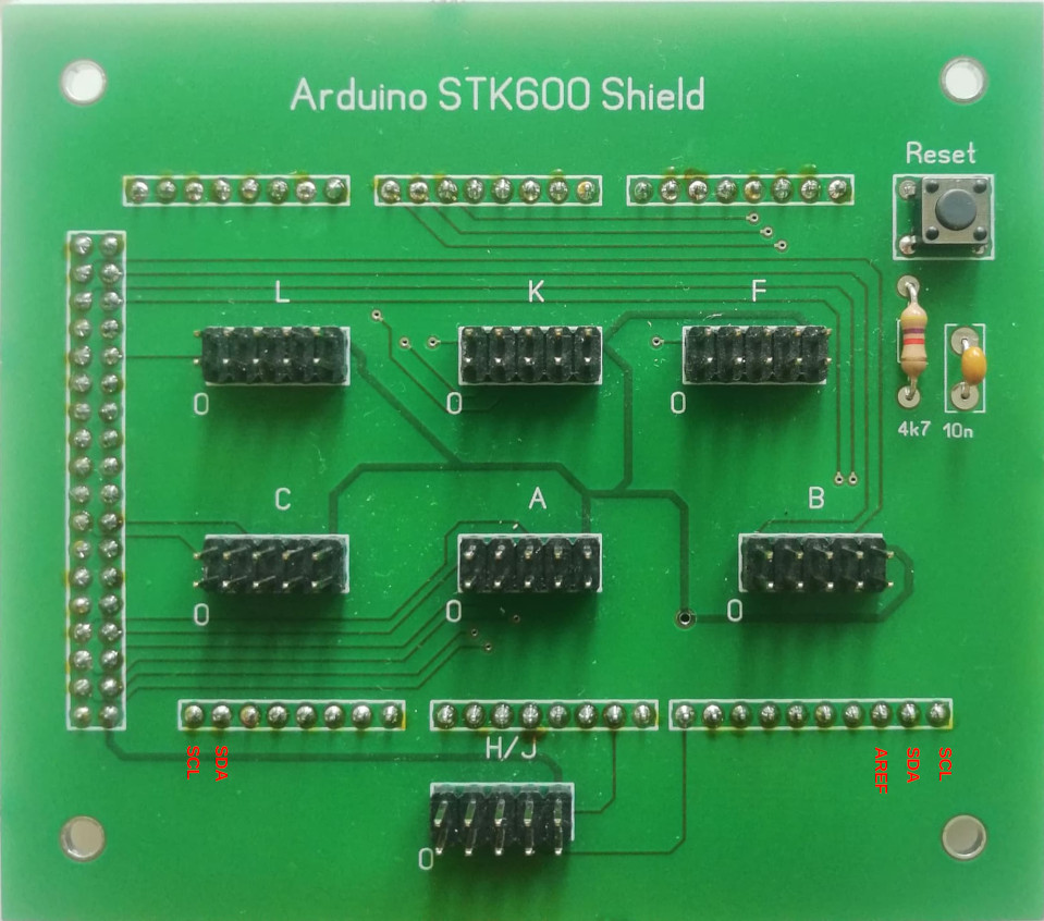

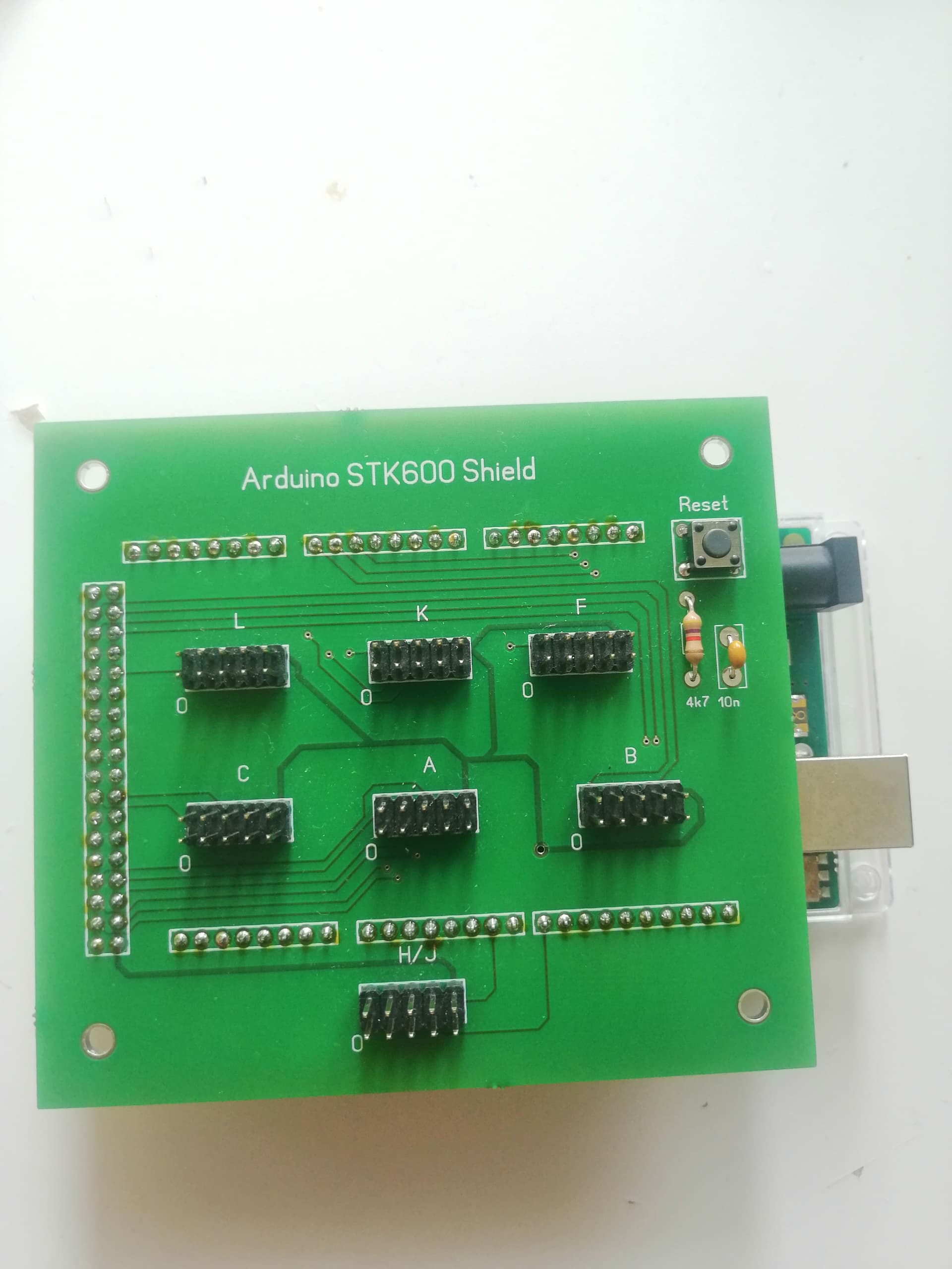

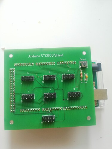

Hi @Koepel, these are the photos of my Shield and the wiring i made. I just wanted to check first with the connections i made in Breadboard before i use the Shield. The Shield is custom made and provided to me by my Professor and told me that he doesnt have any Documentation . So here it is.
I also tested the code you provided for the i2c scanner. It worked.
