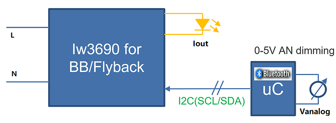

I2C issue-Arduino UNO to dim the iw3690 via I2C according to analog voltage input
@ GolamMostafa
the purpose of the code is simply described in post #7.

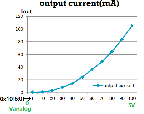

After executing the code in post #3, when I adjust the analog voltage on A0 of UNO, the dimming level is communicated to iW3690 via I2C, actually is the output level register 0x10 of iw3690 is written the updated value. Afterwards iw3690 controls the ON time of MOSFET Q1 in line with the targeted dimming level, thus LED current is dimmed/adjusted. below dimming curve is an example.
Merry Christmas, enjoy the feast.

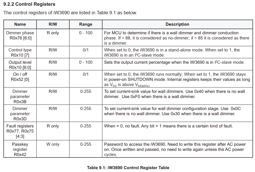

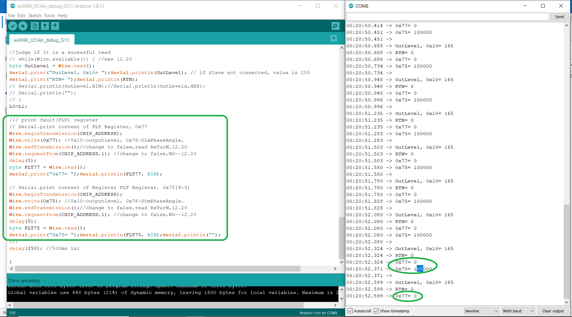

from iw3690 datasheet, I can't find temperature sensor related register, so I added code reading the fault of iw3690(0x77, 0x75[4:3]), from result it can be seen both fault register are OK, meaning no fault happens before the sketch stopping running.
If you know the temperature sensor related register, pls. tell me the address and information, thanks.

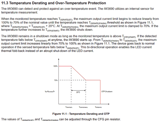

There is a temeperature sensor being used by the internal circuity; its value is not available to the user which I have seen later going throug the Register Set as given in the data sheets that you have mailed to me.

I have an idea to build a double dimmable type driver, phase cut dimming by triac+0-10V dimming via I2C, but the two kinds of dimming are not done at the same time.
for point 1, I make some note below,
for point 2, during I2C dimming situation, mains input is not phase-cut, so full mains is input.

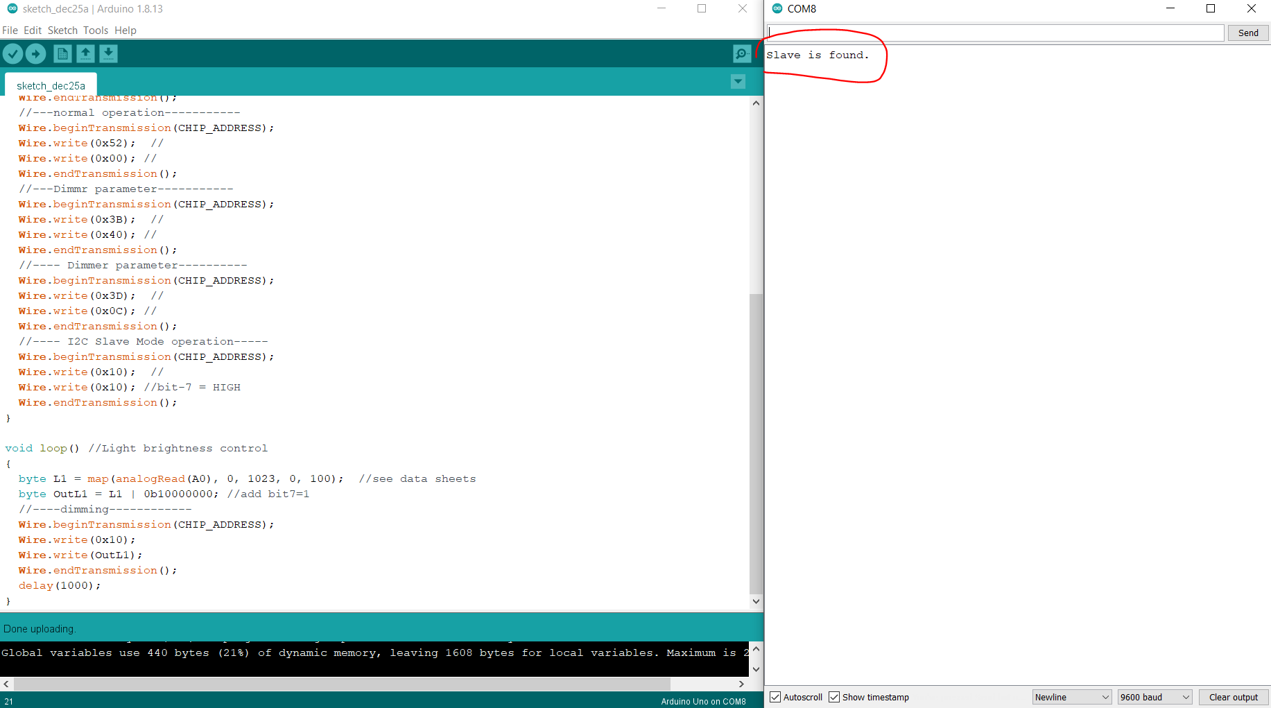

I tried your sketch, result is "salve is not found". I guess the passkey may not be fully written.
Passkey(0x42) is the password to access iw3690,
It is like a group of data(0xA7,0x65,0x3F), I got this from the module on iw3690 demo.
Slave must be detected at slaveAddress 0x38 before any communication may proceed with IW3690!
How could be -- when the data shhets say the value is: 0 - 255 (8-bit)?

iw3690 has response to UNO,
pls. see below,
Thanks! Now, make sense.

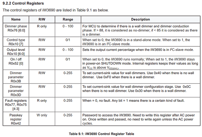

Would be glad to know if you can provide the role of PassKey.
I can only find the information from datasheet,

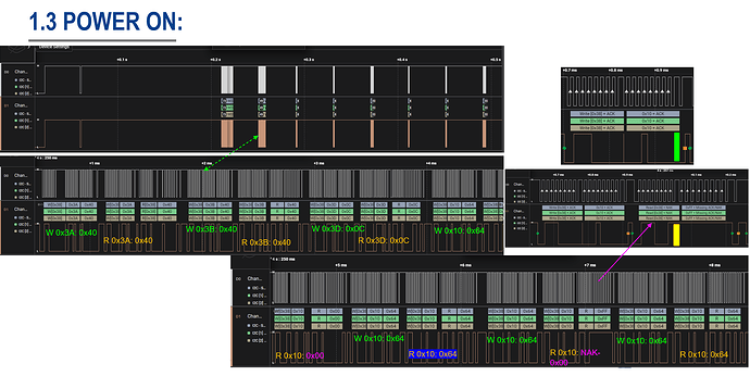

I capture the logic from a module(Bluetooth) mounted on iw3690 demo, shows what is being done at start-up,
for passkey register, it is written 3 different data continuously.
You may try the following codes to observe what happens:
  Wire.beginTransmission(CHIP_ADDRESS);
  Wire.write(0x42);
  Wire.write(0xA7);
  Wire.write(0x65);
  Wire.write(0x3F);
  Wire.endTransmission();
I adde the code based on your previous sketch, it can run longer, from several minutes to ~15 minutes, but finally stops again. when code is running, I tuned the analog voltage and see the dimming is OK, the value of output level register proves the change of the LED brightness.

Another phenomenon, it is same as before.
If 1s interval is set in the loop, code runs ~15min.
if interval is set to 0.33s, code runs ~3min, shorter than that of 1s interval then it stops.
I am wondering whether the sketch will be dead if UNO continuously sending data to slave Iw3690.
As I need to trace the Vanalog to adjust the LED current level in time w/o too much delay, the best interval is ~100ms for continuous update. To save the number of times of communication, that is why in my initial code, a judgement for Vanalog variation is added, if the Vanalog keeps same, i.e., Abs(ΔVanalog)<1,0x10 is not written again.
