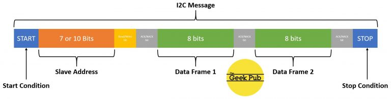

It looks like it is placing the slave address + read/write bit inside the first data frame.
If i request 2 bytes from the slave and the slave responds with 0x01FF03FF, i should get 0xFF and 0x03. What i'm getting is 0x61 and 0xFF.
0X61 is the device address, 0x30, shifted left once and the read/write bit is active.

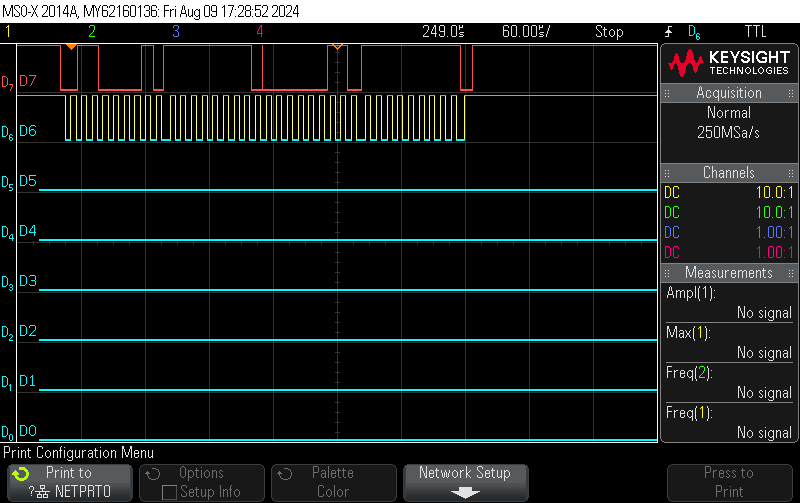

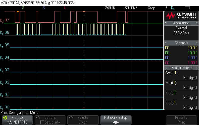

I asked a friend to lend me his nice osciloscope that has a signal analyzer but does not have the decoder package.
ESP32 as master and ESP32 S3 as slave
ESP32 S3 as master and ESP32 as slave
It looks like the slave does not take control of the clock signal. When the S3 is the slave.
EDIT:
I think it is an issue where the slave takes too long to take control of the clock pin and the master sends the request again.
EDIT2:
After reading a bit more it looks like it is only the master that controls the clock pin. This looks like an issue where the S3 does not send an ACK.
