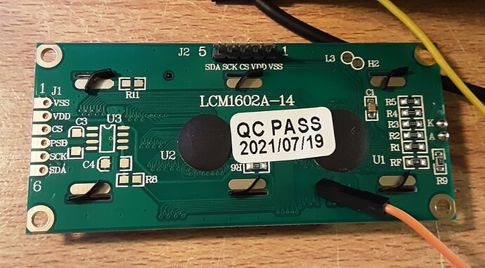

Having zero luck with getting ANY LCD to work. I've got an Uno and a Mega, three LCDs, one with four data lines and two with builtin I2C support.
They all light up.
I can see data activity on the four data line version that corresponds to the timing of the LOOP() but nothing happens. No blink, nada.
The two I2C modules show a line of boxes and a line of nothing.
The I2C modules show up with the scanner as "3E". Changing from the default "27" in the examples to "3E" doesn't help.
I've tried every example and library I can find. NOTHING works, at all.
No command has a response. The backlight stays on no matter what.
Both I2C LCDs behave the same on both the Uno and the Mega.
I got the LCM1602A-14 modules from Jameco, but there is little but the pinout for data. Since it lights up AND responds to the I2C_Scanner, I figure the four wires have got to be right.
I've got everything powered and verified, but no joy in mudville.
I've been able to get the DHT11 I2C modules to work as well as everything else in the kits, but so for getting ANY LCD to do ANYTHING (even blink) is beyond me.
Any help would be greatly appreciated. I'm new to Arduino, but have used GE Fanuc and other controllers so the tech isn't scarey.

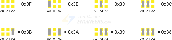

Have you tried 0x3F ? - it is one of the default addresses.
See below re possible addresses on these displays...
I2C Address of LCD
If you are using multiple devices on the same I2C bus, you may need to set a different I2C address for the board, so that it does not conflict with another I2C device.
To do so, the board has three solder jumpers (A0, A1 and A2) or solder pads.
Each of these is used to hardcode the address. If a jumper is shorted with a blob of solder, it sets the address.
An important point here is that many companies manufacture the same PCF8574 chip: Texas Instruments and NXP Semiconductors to name a few. And the I2C address of your LCD depends on the chip manufacturer.
If your LCD has a PCF8574 chip from Texas Instruments:
According to the Texas Instruments’ datasheet, three address selection bits (A0, A1 and A2) are placed at the end of the 7-bit I2C address register.
texas instruments pcf8574 i2c address register
As there are 3 address inputs, which can take 2 states, either HIGH/LOW, we can therefore create 8 (23) different combinations(addresses).
By default, all the 3 address inputs are pulled HIGH using onboard pullups, giving PCF8574 a default I2C address of 0100111Binary or 0x27Hex.
By shorting the solder jumpers, the address inputs are puled LOW. If you were to short all three jumpers, the address would be 0x20. The range of all possible addresses spans from 0x20 to 0x27. Please refer the below illustration.
If your LCD has a PCF8574 chip from NXP Semiconductors:
According to the NXP Semiconductors’ datasheet, three address selection bits (A0, A1 and A2) are also placed at the end of the 7-bit I2C address register. But other bits in the Address Register are different.
nxp semiconductors pcf8574 i2c address register
Again! The 3 address input can have 2 states, either HIGH / LOW, giving us 8 (23) different combinations.
By default, all the 3 address inputs are pulled HIGH using onboard pullups, giving PCF8574 a default I2C address of 0111111Binary or 0x3FHex.
By shorting the solder jumpers, the address inputs are puled LOW. If you were to short all three jumpers, the address would be 0x38. The range of all possible addresses spans from 0x38 to 0x3F. Please refer the below illustration.

Hi @madmark2150
From the photo in #4 and #7, I think your display is not I2C, but SPI.
SDA SCK AND CS pins look like BUS SPI designations to me.
RV - mineirin
Have you tried a couple of external pull-ups (4.7k) on the lines on the I2C devices?
For the display that has the 4 data lines direct... what out put are you getting? Does it have a contrast pot you can adjust? Sometimes the characters are not visible if contrast is not set correctly.
Nothing worked. i put a contrast pot and and 220 ohm resistor as indicated in the schematic, but no joy.
I need to add pullups. Resistors are on order. But again, why is the scanner seeing it? I read the I2C discussion about pullups and thought you could get away without for a single device on the string.
Ok, now what? The data sheet is non-existent.
I specifically ordered the 5v model. The library won't install, say not valid format.
You may be out of luck with that display.

I found this page on this display.
|3|CS|Chip Select Pin:
  • "Low": 3-line Interface
  • "open": I2C Interface
To select the I2C interface.
And this library for Arduino boards.
Datasheet for the display.
@bperrybap will the hd44780 library work with this display?
Maybe this...
