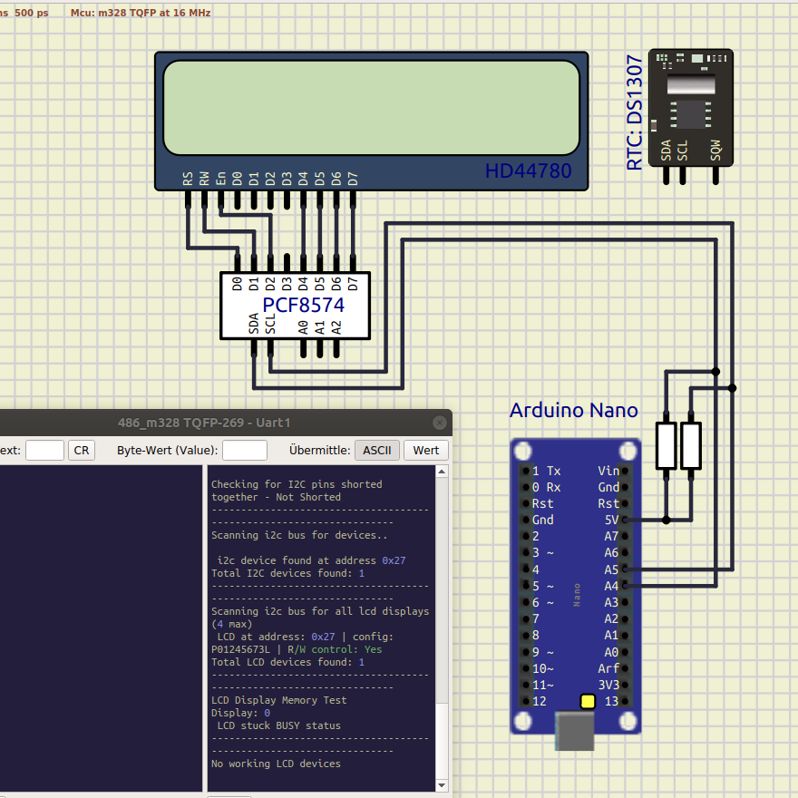

I have tried this with the following result:
Serial Initialized
I2CexpDiag - i2c LCD i/o expander backpack diagnostic tool
hd44780 lib version: 1.3.2
Reported Arduino Revision: 1.8.19
CPU ARCH: AVR - F_CPU: 16000000
SDA digital pin: 18 A4
SCL digital pin: 19 A5
Checking for required external I2C pull-up on SDA - YES
Checking for required external I2C pull-up on SCL - YES
Checking for I2C pins shorted together - Not Shorted
Scanning i2c bus for devices..
 i2c device found at address 0x27
 i2c device found at address 0x68
Total I2C devices found: 2
Scanning i2c bus for all lcd displays (4 max)
 LCD at address: 0x27 | config: P01245673H | R/W control: Yes
Total LCD devices found: 1
LCD Display Memory Test
Display: 0
 LCD stuck BUSY status
No working LCD devices
the hardware works with a library named "Soft_LCD-I2C" but this is unstable (in my opinion) and unsupported. :-/
That often indicates a problem with wiring or soldering of the backpack to the LCD or, less likely, the soldering on the backpack itself.
Please post some clear photos of the LCD and backpack showing the soldering.
Disconnect the RTC, temporarily, and run the diagnostic.
I am not at home now. So I test this in "Simul-IDE" – with the same result. It seems to be another problem?!?
I will suspend judgment till I can see the result on real hardware.
I have actually used an I2C enabled HD44780 display with the hd44780 library and a DS1307 before with no trouble, so I know that the combination works. The hd44780 library is in wide use so I, also, trust the library.
I have seen many simulators and have little trust in them. That is just my opinion formed over 50 + years in the electronics and microcontoller hobby. Some are better than others, but I have yet to see a perfect sim.

Hi Karsten,
you can find an example in the Simul-IDE Project Forum but I agree with groundFungus and v205! hd44780-lib, RTClib and Time-lib is the perfect choice!
Best regards.
Hi Karsten,
follow the tip of the author Bill Perry:
https://forum.arduino.cc/t/lcd-1602-with-i2c-problem/645404/11
modify one line in the I2CexpDiag sketch and it works. :wink:
Well, it at least gets a bit further.
It could be that the SimulIDE simulator is incomplete and does not fully/properly support reading the LCD through the PDF8574 chip.
This used to be an issue for Wokwi. I worked with the Wokwi developers to get LCD reads working properly so I2CexpDiag now works with Wokwi.
@karstenlehmann
Can you post some photos of your hardware so we can look at the soldering on the header pins and the PCF89574 chip?
--- bill
