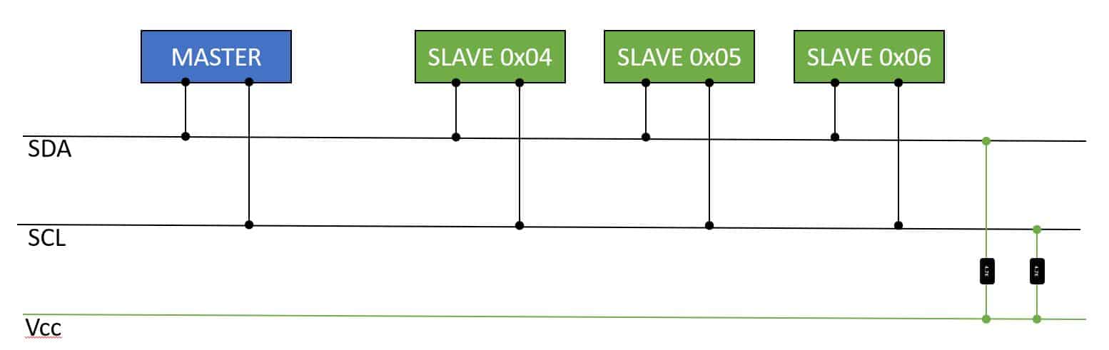

Can you draw a basic block diagram of what you have in mind please?
Thanks.. Tom... :grinning: :+1: :coffee: :australia:
Untitled Diagram

Why can't you have one master and the rest slaves?
That is how I2C is designed.
The master and the slaves each have unique addresses.
The master polls any slave by calling it on the I2C BUS.
The master and slaves ALL share the same I2C BUS.
Tom.... :grinning: :+1: :coffee: :australia:
