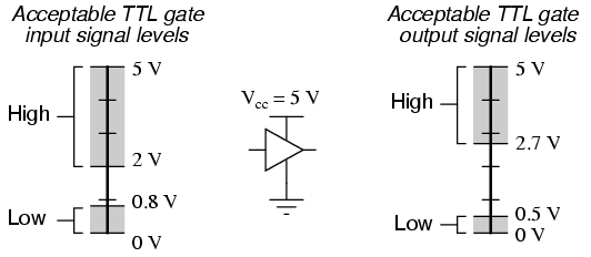

"TTL LEVEL " is the universal term for 5V logic. No one cares if TTL is obsolete. TTL LEVEL means 5V logic and everyone knows that. (except you apparently). No one uses the term "CMOS LOGIC" because is means nothing.
arduino is "TTL "LEVEL"
The Arduino is built on a slightly more robust platform. The most noticable difference is that the invalid region of voltages is only between 1.5 V and 3.0 V. The noise margin is greater on the Arduino and it has a higher threshold for a LOW signal. This makes building interfaces and working with other hardware much simpler.

What that means is that it is NOT standard CMOS level. It is 5V logic but TTL COMPATIBLE.
If it is TTL COMPATIBLE that makes it "TTL LEVEL"
I stand by my previous statement. No matter where you go , no matter what product you look at, no company describes their product as "CMOS LEVEL" or "CMOS COMPATIBLE", or "CMOS SERIAL".
They ALL use the standard term "TTL LEVEL" ,"TTL SERIAL, or "TTL COMPATIBLE".
ARDUINO LOGIC LEVELS ARE TTL COMPATIBLE.
If you don't believe that then hook up an old 1970s series 7400 TTL chip to an input or output and it will work, every time. To say the arduino GPIO is "CMOS LEVEL" is BS. It may be CMOS circuitry but it's TTL LEVEL and TTL COMPATIBLE.

I'm with raschemmel on this one. Some terms just get a new kind of meaning after a while. TTL is dead and indeed and I agree TTL serial refers to inverted serial with 5V levels. Some words just become a synonym for something bigger. Like Googling refers to finding something on the internet and Arduino refers to micro controller devboards etc.

As you can see from the datasheet, the MAX485 is a "TTL " to Differential Drive transceiver. (SEE PAGE 12 , Figure 14, where it says "TTL in ")
Clearly the OP doesn't want the MAX485 because he wants I2C/RS485 , not TTL/RS485.
