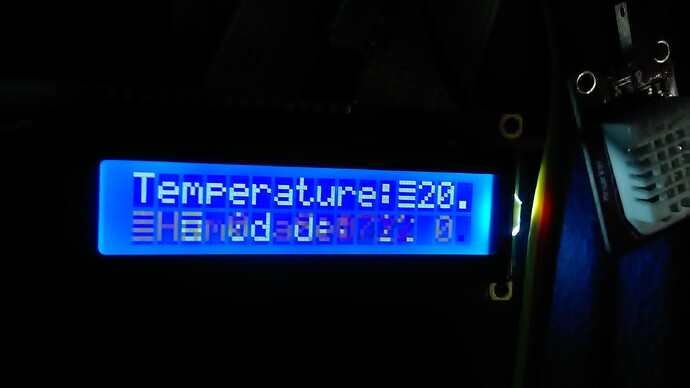

hello evrybody , i am using an i2c lcd in my project to show temperature and humidity
but it shows me only the first line , the second is not clear even i changed the contrast , could somone give me a hand

I can't really see the display in the photos you posted earlier to understand what you mean by:
"... it shows me only the first line , the second is not clear even i changed the contrast ..."
I don't see anything obvious in the code other than you are constantly clearing the screen before updating it.
That will cause flicker effects and the 2nd line will experience more of the effect since the characters on the 2nd line will be on the display for a shorter amount of time before the next clear.
You really want to avoid using clear(), it is a relatively slow operation, and cause flicker effects.
There are many techniques to do this, but it usually involves just updating the display when something changes or after a period of time.
And even then, it is still better to avoid using clear() so that what is on the display is never erased.
i.e. the display is simply updated/over-written with the new characters.
What creates the flicker effects is the period of time where there is nothing on the display to the point in time where it is updated with the new characters.
Other than that, maybe you could provide some additional description of what is on the display vs what you expected to be on the display and post some clearer photos of the display so we can see it too.

The normal path through that code prints 2 lines to the LCD, delays 10 milliseconds then clears the LCD.
Simple fix: increase the delay.
Correct fix: don't clear. Remember what you last wrote to the LCD and only overwrite the digits necessary. If you last wrote "10.0" degrees and it is now 9.9, write an extra space to overwrite the additional digit.

As you increase the delay, at some point, the button response will start to suffer.
Personally, I wouldn't try to solve a flickering issue that way as there will still be some amount of flickering due to clearing the display before updating. This is particularly true with a slower interface like when using an i2c backpack and the LiquidCrystal_I2C library being used.
If you use the hd44780 library with the hd44780_I2Cexp i/o class library, the display could be updated twice as fast so the flickering would be reduced, but still not eliminated.
You don't have to remember what you wrote, if the fields are always fixed width.
While not optimal, constantly updating the display with the same characters including numbers will not cause flicker.
An optimization, would be to only update the display when something (like the number(s)) change.
using xxprintf() would make it easy to print the lines with fixed width fields.
However..... If the Arduino being used is using an AVR, like an Uno or Mega etc..., then floating point in sprintf() is not supported by default and is quite a pain to enable.

Whenever we see someone refer to a "flickering" LCD display, we pretty much know that they are using lcd.clear in the loop() - and that is almost always a bad idea.
Even if you want to change the display to a different menu item or such, it is most efficient to home the cursor and overwrite both lines.
Numerical display sections do need to figure out (in advance) how many digits will be printed and add leading blanks to pad them to a fixed size, so that the decimal does not jump between 9.9 and 10.0 and such.

Not sure about efficiency, but it is definitely faster to write all 32 characters on the 16x2 display than to use the "Clear Display" command, which is what clear() does.
The home() function is also very slow much slower than setCursor(0,0) as home() uses the "Return Home" command which does lots of internal initialization inside the display.. i.e. home() is very different from setCursor(0,0)
setCursor() takes the same amount of time as writing a single character to the display.

Achref-Abbassi:
the code must allow me to set the date with tow buttons first , and show the temperature and humidity measured by a DHT22 sensor , that's all , other parts of code is to command the relays for a bulb that's all .
the code is true on IDE but it don't give what i want on LCD . it makes me crazy :frowning:
That isn't what your code is doing.
I see no date support in this code.
The code does calculate elapsed total days, hours, minutes, seconds and then the fraction portion of hours, minutes, seconds elapsed, since the arduino was reset but has no knowledge of the actual date or time.
It also supports setting a value to control temperature with two buttons, but nothing related to setting a date or an elapsed time.
Using millis() time tracking can be an issue since if there is ever a power loss, time starts over again.
Also, the millis() counter will roll over after a period of time. If the counter is 32 bits - which is common - then it rolls over after around 49 days. That may or may not be acceptable for your use.
The issue for your LCD display is/was more than just using clear()
You are trying to print more than fits on a 16x2 display, including writing line 1 twice.
Was this code originally intended for a 20x4 display?
Look at the code:
The comment says :
  //Print temperature and humidity in first two lines
The code is actually printing 3 lines (overwriting line 1) with more characters than 16 characters on each line and the display is only 16x2.
(I broke it up into 3 sections to describe it)
This code prints on line 0 starting at column 0
    lcd.setCursor(0, 0);
     lcd.print("Temperature:");
    lcd.write(byte(0));                       // Write the Thermometer icon
     lcd.print(t , 1);
    lcd.print((char)223);
    lcd.print("C  ");
Characters on line 0:
"Temperature:"   12 characters
byte(0)           1 character (garbage since custom char 0 was never setup)
(t,1)             4 characters ##.#
(char)223         1 character
"C "              2 characters
Total of 20 characters on a 16 line display.
Ths code prints on line 1 starting at column 0
   lcd.setCursor(0,1);
   lcd.write(byte(1));                         // Write the drop icon
    lcd.print("Humidade:");
    lcd.print(h, 0);
    lcd.print("%");
    lcd.print(" ");
   lcd.print(ic);
Characters on line 1
byte(1)           1 character (garbage since custom char 1 was never setup)
"Humidade:"       9 characters
(h,1)             2 characters ##
"%"               1 character
" "               1 character
"C "              2 characters
(ic)              1 character  0 (will not print a custom char, is zero since never initialized/used)
Total of 17 characters on a 16 line display.
This code also prints on line 1 starting on column 0 immediately overwriting the previous characters written to line 1
The characters printed will vary in length and position depending on the values of the variables.
It is not printing fixed width fields for the numbers.
Overwriting the line along with printing characters whos locations move around depending on the values of the numbers is the main issue causing visual issues on the display.
   lcd.setCursor(0, 1);
   lcd.print("  ");
   lcd.write(byte(3));
   lcd.print(" ");
   // Print timein format Time: xxd:xxh:xxm:xxs
 lcd.print(id);
   lcd.print("d ");
   lcd.print(ih);
   lcd.print(":");
   lcd.print(im);
   lcd.print(" ");
   lcd.print(is); lcd.print(" ");
   lcd.print(val,1);
characters on line 1
" "               1 character
byte(3)           1 character (garbage since custom char 3 was never setup)
" "               1 character
(id)            1-2 characters depending on value of number
"d"               1 character
(ih)            1-2 characters depending on value of number
":"               1 character
(im)            1-2 characters depending on value of number
" "               1 character (note: other seperators are ":" not <space>
(is)            1-2 characters depending on value of number
" "               1 character
(val,1)          4+ characters ##.# but could be more depending on value
Total of 15-19+ characters on a 16 line display.
[tt]
[hr]
You have some work to fix these issues.
--- bill
tank you very much Bill , i found solution thank to your help , you can see the picture in the attachement .
