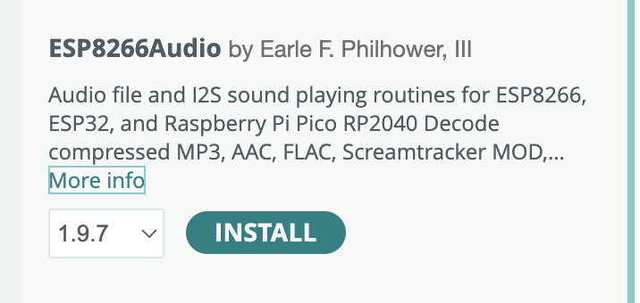

Try this one, it works with RP2040
HI, I am trying to achieve the PWM or I2S in the mbed architecture. As that is also where the voice recognition module lies. Within supported architecture here, in library properties:
https://github.com/earlephilhower/ESP8266Audio/blob/master/library.properties
It only shows RP2040 which is not the same as mbed_os. This wont be compatible for what I am looking for. It kind of explains my predicament.
Thanks
