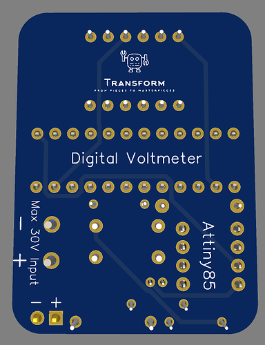

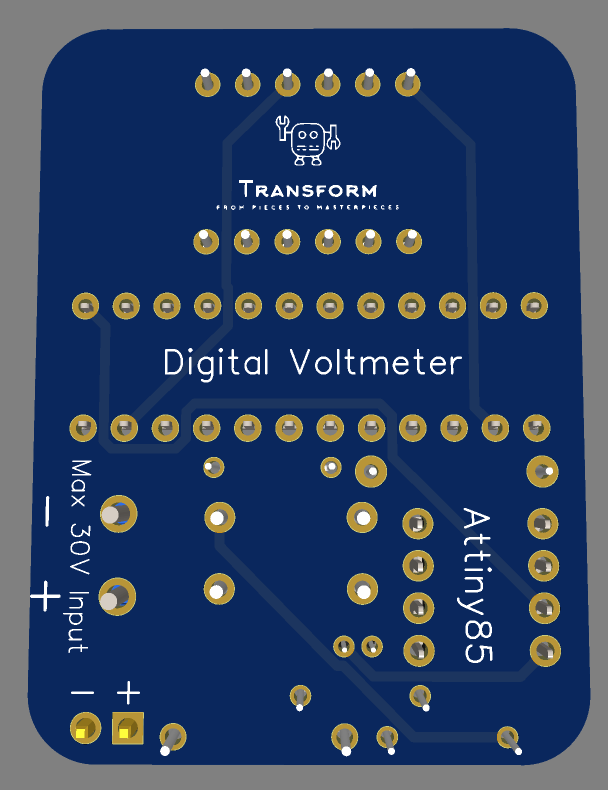

I think i'll just stick with the MAX7219. What do you all think of this schematic and 3d designs?
Did you forget the mandatory two caps on the HE6350MPR regulator,
and it's 18volt absolute max input voltage (not 30volt),
and the decoupling caps for the ATtiny85.
Leo..
I think you could make a PCB the same size or smaller, by using a bigger AVR that wouldn't need a separate decoder...
Maybe an ATtiny861 (which even seems to be unpopular enough that you can still buy them!) (Supported by Spence's ATtinyCore)
