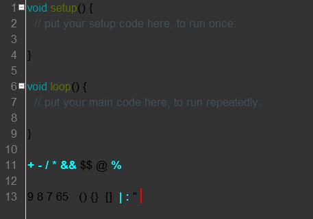

In theme.txt, which section controls the color for these characters, { ( ![ $ @, and numbers like 1 2 3.
Right now they are default black and I am using a dark background resulting in these characters almost illegible. I have experimented with various changes all to no avail.

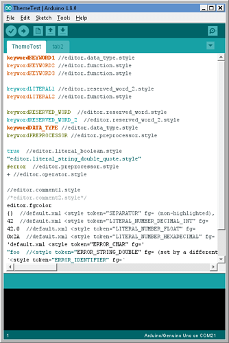

I have written some documentation for the Arduino IDE theme system, as well as a dummy library and example sketch for testing all theme properties here:
Note that, in addition to theme.txt, some theme properties are also defined in syntax/default.xml.
You probably already know, but just to be sure I'll mention thatyou need to restart the Arduino IDE before the changes you make to the files take effect.
Here is a screenshot of the example sketch that has the theme property names for each editor text coloration in the comments:
