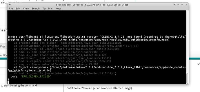

I tried the zip file too. I have unzipped it in a local folder and tried to start by using the command
./arduino-ide
But it doesen't work. I get an error after a long printed output (see attached image).
Excellent. That is very useful information.
Are you using a very old version of your Linux distro (e.g., Ubuntu 16.04)?
This error occurs when you have too old a version of the IDE's libstdc++ dependency installed on your computer. If you are able to update your distro, that would probably fix the problem. If not, I see some instructions for updating libstdc++ here:

What do you get if you run this command?
strings /usr/lib/x86_64-linux-gnu/libstdc++.so.6 | grep GLIBCXX

version 3.4.22 is not there... :thinking:
How I can install GLIBXX 3.4.22 if the apt tool refuses doing that?

I think if you build Arduino IDE from source then it would. The dependency is based on the machine used for the build. The builds distributed by Arduino are made on a machine running Ubuntu 18.04. This older version is used even though newer ones are available specifically to provide support for older distros (but not so old as yours):
Unfortunately building the IDE from source is a somewhat advanced endeavor.
