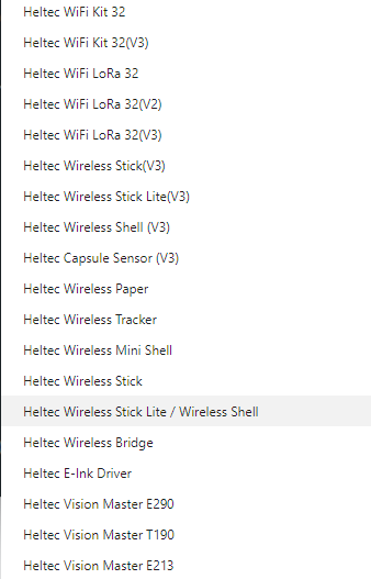

Here is what my additional URL’s looks like

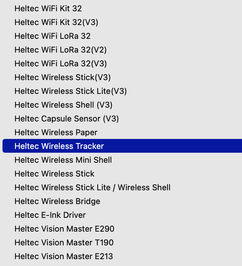

Here is what my menu Tools/Board looks like
and here is what the Heltec portion of esp32 looks like
Maybe you can compare and see a difference.

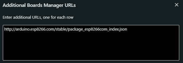

Do you really need all of those URLs ?

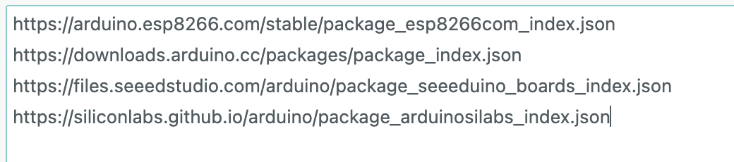

Here is my additional URLs section of my Preferences

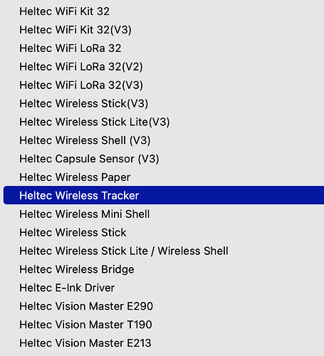

And here is what the Heltec section of the ESP32 boards looks like
I think so, the last one is for the XIAO MG24 that I am playing with and the 2nd last is the rest of the SEEED Studio boards. I am switching to the XIAO ESP32-S3 Sense since the camera is so tiny I will be better able to hide the trail cameras.
I don’t know where the 2nd entry came from, I think it was automatically added. I will try removing it and see what happens. Nothing happened so I am not sure what it’s for.
I used to also have teensy and attiny as well.
At one time I had even more until someone told me that they were now included in the Arduino standard but were maybe a few weeks behind if that is important.
It is not automatically added, so you must have added it at some point.
You can safely remove it. Its presence shouldn't cause a problem, but it is also completely redundant so there is no reason to have it.
This is the primary package index. It provides the data for the boards platforms that are always listed in the Boards Manager, even when you haven't added any URL at all in your "Additional Boards Manager URLs" preference. This URL is hardcoded into Arduino IDE, so there is no need to add it to your preferences.
I think that was the URL for the "esp32" boards platform. You are correct that it is no longer mandatory, since that platform is now listed in the primary package index. For anyone interested in the subject, there is some related discussion here.
The situation is the same for the "Silicon Labs" platform. That platform is listed in the primary package index, so it is not necessary to [add the package index for the platform's dedicated package index URL in your "Additional Boards Manager URLs" preference]("Additional Boards Manager URLs" preference). So you can remove the following entry from your preferences if you like:
https://siliconlabs.github.io/arduino/package_arduinosilabs_index.json
