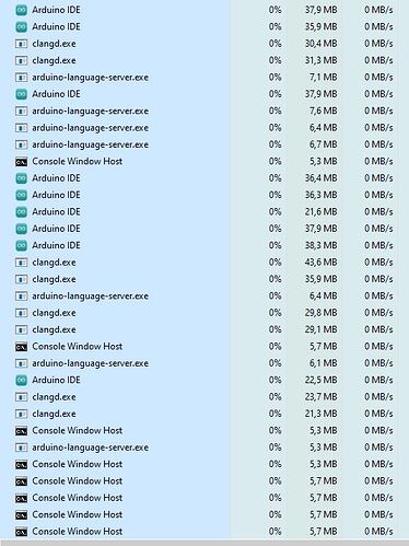

In a case when the menue was visible, i.e. all OK, task manager shows multiple (34) tasks for Arduino IDE, see attachment. Maybe this is ok but nevertheless it is strange.

Yes, there are a bunch of tasks. I never counted them, so I don't know if 34 is normal.

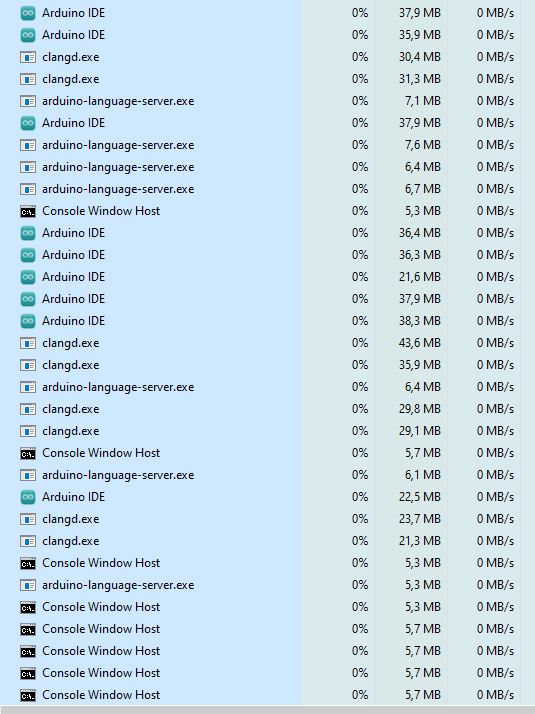

The task manager showed 70 Arduino tasks, see attached Arduino70.jpg and Arduino70+.jpg.
I saw it in a post here a few months ago, that is all I remember. Have a look at the hidden dir .arduinoIDE then look at file settings.json. The entries in there look a lot like what you are looking for. I think that file was created via the usual Shift-Cmd-P in the IDE on a MAC, the Cmd key will be different for a Win PC.
That does seem like a lot, maybe re-boot and see how many, it should be zero. Then stafrt one IDE and look. Remember the product the IDE was built from has a lot of 127.0.0.1 type processes for various tasks. There is a lot more going on under the covers than you may realize.
