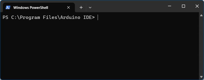

I tried to follow your instructions and got as far as this Powershell screen - I think something is wrong here? (see .png attached)
Also, I found that I have Arduino files in both the places you mention: c: Program Files/Arduino IDE and c:/users/my_name/AppData/Local/Arduino 15 but the former location is I think the only one containing Arduino IDE.exe
Should I delete c:/users/my_name/AppData/Local/Arduino 15 ?
Are you sure that you completed steps #3 and #4 as instructed?
In step #3, did you go to C:\Program Files\Arduino IDE and confirm that you see the file Arduino IDE.exe there?
Then, in step #4, did you Shift-right-click in an empty part of the folder contents (i.e., the right pane of the File Explorer) before selecting "Open PowerShell window here"?
If you had done so, you should have seen a PowerShell window with a prompt of the form PS C:\Program Files\Arduino IDE, as shown below:
In your screenshot, the PowerShell prompt is PS C:\WINDOWS\system32, which makes me think that you did not correctly follow the instructions for steps #3 and #4.
Alternatively, you can open a PowerShell window any which way, and then type the following commands:
cd "C:\Program Files\Arduino IDE"
dir "Arduino IDE.exe"
This should produce a result like the following:
Once you've reached this point (with the correct form of the PowerShell prompt), you can proceed with step #6.
