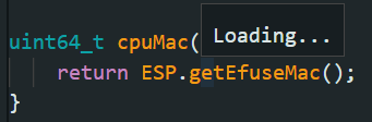

IDE has high resource usage and "Rename Symbol" feature doesn't work for occurrences off screen
Unfortunately the IDE is heavily buggy and using so much resources.
It is literally kicking the air with its little feet when it comes to ESP32 projects.
It can not manage symbol tables etc. so forget about renaming, refactoring.
Even during renaming a local variable in a function, it forgets to rename the variable instances which are not visible on screen if the function is longer than visible part of the editor...
Keeps scanning, loading for symbols for a (loong) time, then seems to work proper, then it gives up.

This is taking forever...
And then it randomly works or does not work at all for symbol information. Which is taking me back to 42 years back, before the IDE era, when I started programming on sinclair spectrum etc :D...

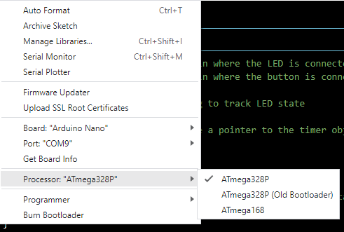

Ok, I tried 2.3.2 appimage after 1.8.19 stopped working after an update yesterday. I can't say I'm impressed at all - to be honest, I id not expect to be. List of things I did not find a way to work around:

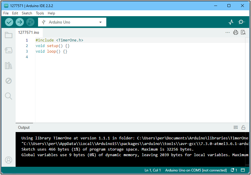

  • While it recognizes most of the libraries from 1.8,19 installation it fails miserably on others (e.g. TimerOne.h)
  • AVR old bootloader is gone. Is this to prevent chinese "clones"?

Works fine for me:
Maybe you installed the TimerOne library to the libraries subfolder of the Arduino IDE 1.8.19 installation folder instead of under your sketchbook?
Arduino IDE 1.8.19 comes with a collection of fundamental libraries bundled with the installation. Unfortunately the practice somehow developed in the Arduino community of installing additional libraries in that location, and this approach is even used in the installation instructions in some 3rd party library documentation and tutorials. Obviously Arduino IDE 2.x is not going to recognize any libraries that are installed under the Arduino IDE 1.8.19 installation folder.
No, it's installed in sketchbook/libraries. But I'm on Linux.
