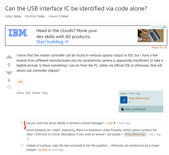

Identifying chipset on Uno
Nothing I have, electronic or physical, can get a decent image.
Moot at this point, it's an ATMega328P with a CH340.
Looks like it uploaded and verified

Having read this again, I'm not understanding what you are trying to achieve. If you have an UNO, then the main chip should be an ATEMAG328P. Those other chips you mention may or may not be used to implement the USB-serial connection between the ATMEGA328P and the host PC.
What is requiring you to specify a chipset? If you are trying to re-target the UNO code to run on one of those other chips, then you would need to know what the UNO code did and what hardware (UARTs, SPI, I2C, PWM etc) it might need and if that functionality is present on one of the other targets.
I wanted to use a custom bootloader. But the issue is solved arduino.se hooked me up
The USB chip can be identified based on VID and PID. But a clone Mega with CH340 and a clone Uno with CH340 will report the same VID and PID.
Not sure how that helps to identify the main processor.
