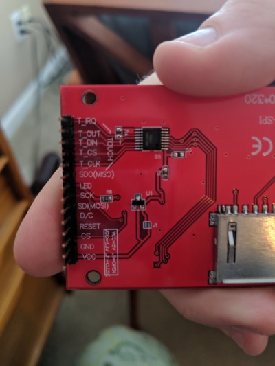

I've recently bought two sizes of ILI9341 TFT LCD touch screens for use in a project. Both are identical to the pictures presented.
2.8" TFT ILI9341
2.2" TFT ILI9341
However, I'm having trouble getting them working (both just display a blank, white screen). I've tried running various examples out of the box under the Adafruit ILI9341 and MCUfriend_kbv libraries, with no progress. So far, for the 2.8" screen, the MCUfriend_kbv diagnose_TFT_support file thinks the address is 0xD3D3 according to tft.readID() and lists the following as a possible fix:

MCUFRIEND_kbv is intended for Mcufriend Uno Shields that contain an 8-bit parallel display controller.
Your first link says: 2.2"/2.8" TFT LCD Display Panel SPI Serial 240*320 5V/3.3V ILI9341
The second link says: 2.2" 2.2 inch SPI TFT LCD Display module ILI9341 240x320 51/AVR/STM32/ARM/PIC
They contain an onboard 3.3V regulator that means you can connect the VCC pin to 5V.
Note that these Red displays require 3.3V logic. Every logic signal needs a level shifter if you want to use a 5V Arduino like Uno, Mega, ...
Install Adafruit_ILI9341 and Adafruit_GFX libraries via the IDE Library Manager.
Use level shifters. Always connect the RST pin. Always use the full-fat constructor i.e. uses the RST argument.
All the boards in your links seem to have transistors to switch the backlight LED. i.e. the LED pin is a 3.3V logic signal which requires a level shifter or series resistor.

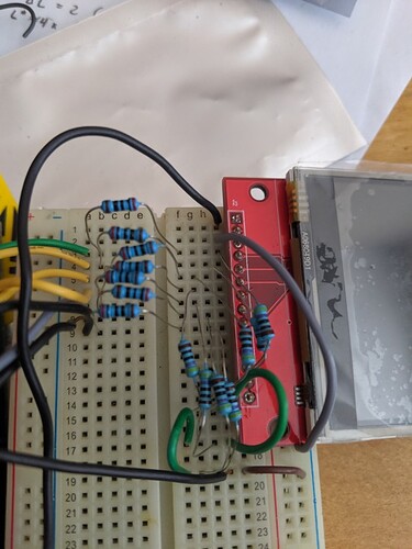

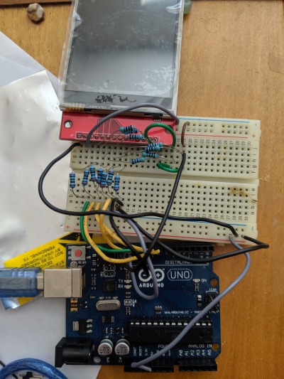

I deleted all custom libraries associated with this project from both Documents/Arduino/libraries and User/Downloads, and then reinstalled them via the Library Manager in Tools in the Arduino app. It looks like there was an extra library the ILI9341 needed to install that I never found - however, upon installing everything, the graphicstest.ino example compiled correctly, which is a step in the right direction.
The 2.8" TFT now runs the graphicstest example perfectly! However, the breakouttouchpaint and touchpaint examples still default to the white screen. I've attached pictures of my wiring below:
(This is the wiring tutorial I followed.)
The group of resistors at the Arduino pins are all 200 ohms and the group of resistors all leading to GND are all 470 ohms.
200R and 470R are pretty low value resistors. Your Uno will have to drive 7mA through them for every HIGH logic signal. The Uno has sufficient drive current but it is rather wasteful.
