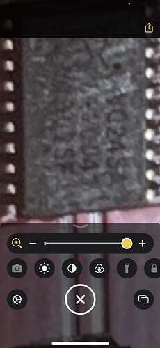

The next question is what is the part number printed on U2, U3 ?
Thanks David. Not sure what you mean by U2, U3. There is a SKU:UNO3501 part number on the packet if that helps.
Look at the pcb. There are chips marked as U2, U3. A regulator with 3 terminals and a thick tab. A resistor R1, RESET switch, microSD holder.
I realised that just after I posted😩
It looks like the numbers have been scrubbed off U2 and U3. The voltage regulator numbers are clear but not the others. I will have a look tomorrow with a better magnifier and light and report back.
I think I can make out VC245A on U3 and possibly the same on U2.
No, I can't understand why anyone would scrub the number from a $0.10 buffer chip. But it looks nearer LVC245A than HC245A
Which is excellent news because LVC245A is input voltage tolerant and makes it work properly on a 5V Uno or Mega2560.
David.
I can confirm it’s LVC245A. I took a photo but it’s not as clear as what I can actually see.
Thanks again for you help.
