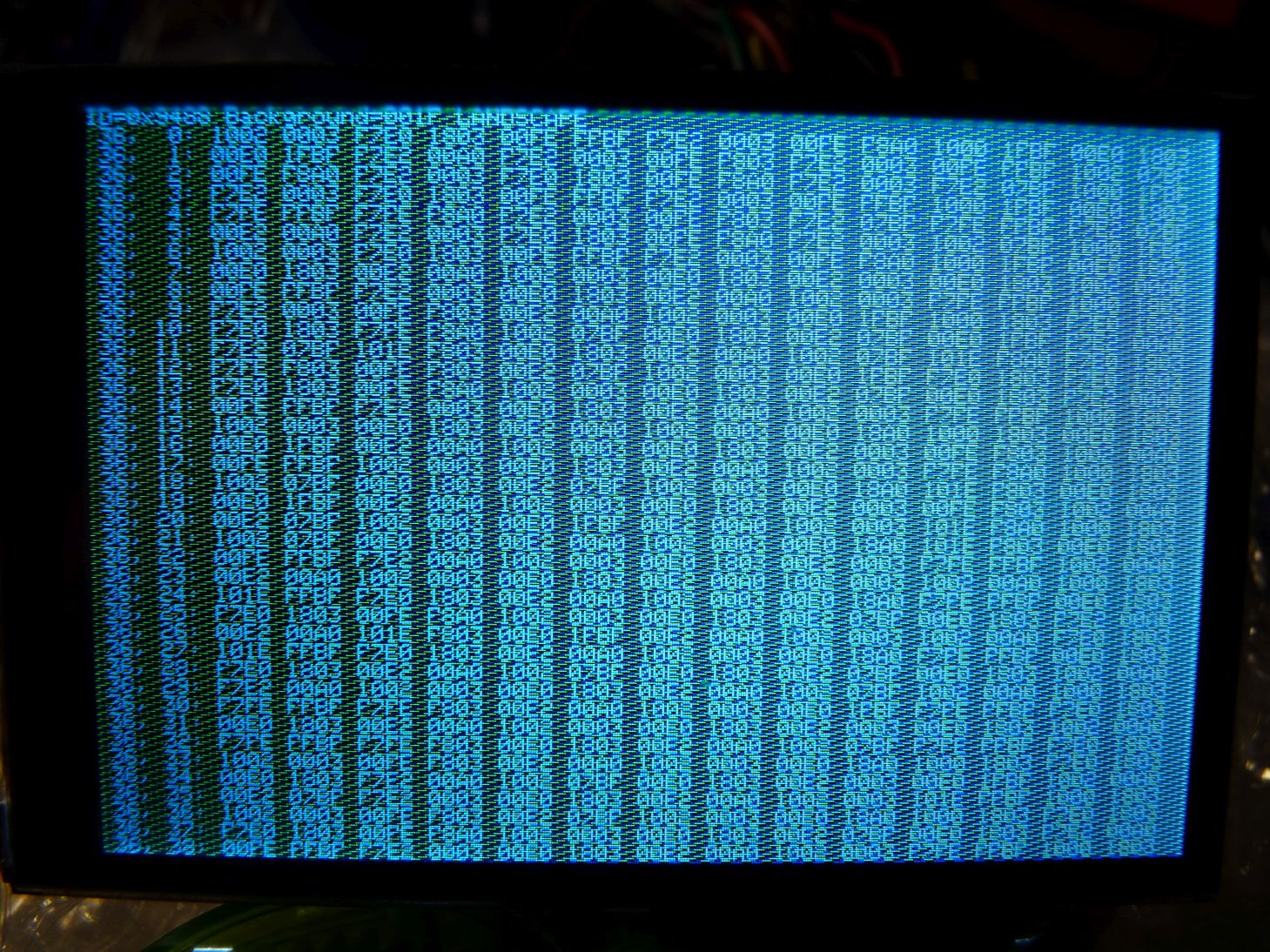

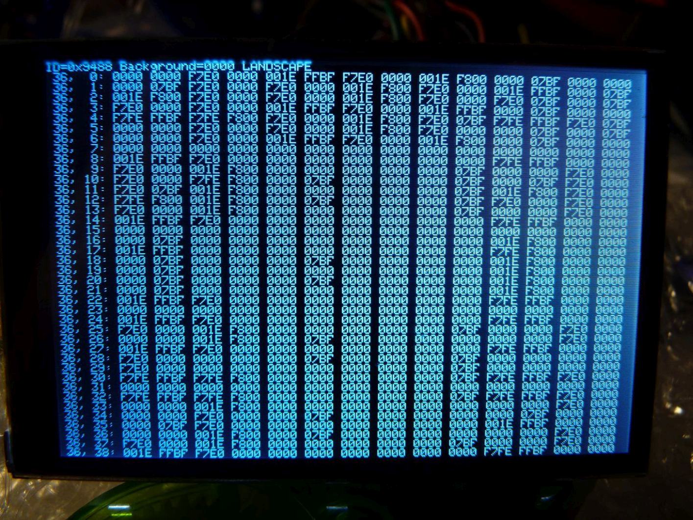

ili9488 with tuoch screen
That is exactly how it should look. You can see the 4, 0, 1, 2, 3, 4, 5 vertically and half of an 8 on the right.
In Landscape mode, you can see the vertical line of ":" and all of the 8 . Probably half of the 6.

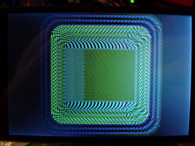

Hello!
I'm quite new to the Arduino and absolutely new here :slight_smile: I bought a few things to mess around with, one of them is a 3.5" touch TFT with ILI9488, but I can't get it working. Ebay link
I'm using a Mega2560 with UNO-like connection (so I use A0-A4 intstead of the digital pins).
What I could figure out from the description and the internet, that the test code should work with UTFT, if I replace the original initlcd.h with their code. I did it, but it acts, well, strange.
If I use David's mcufriend_kbv stuff, it kind of works. For example the graphictest animation is smooth, but the colors are wrong (whatever library I use, the colors are always bad). It's like everything is made of alternating color stripes.
If I use the adafruit library, it either doesn't work at all, or works, but flickers, have wrong colors and sometimes the screen size is set wrong. If I create a sketch with only the LCD initialization and a white background, it also flickers like crazy.

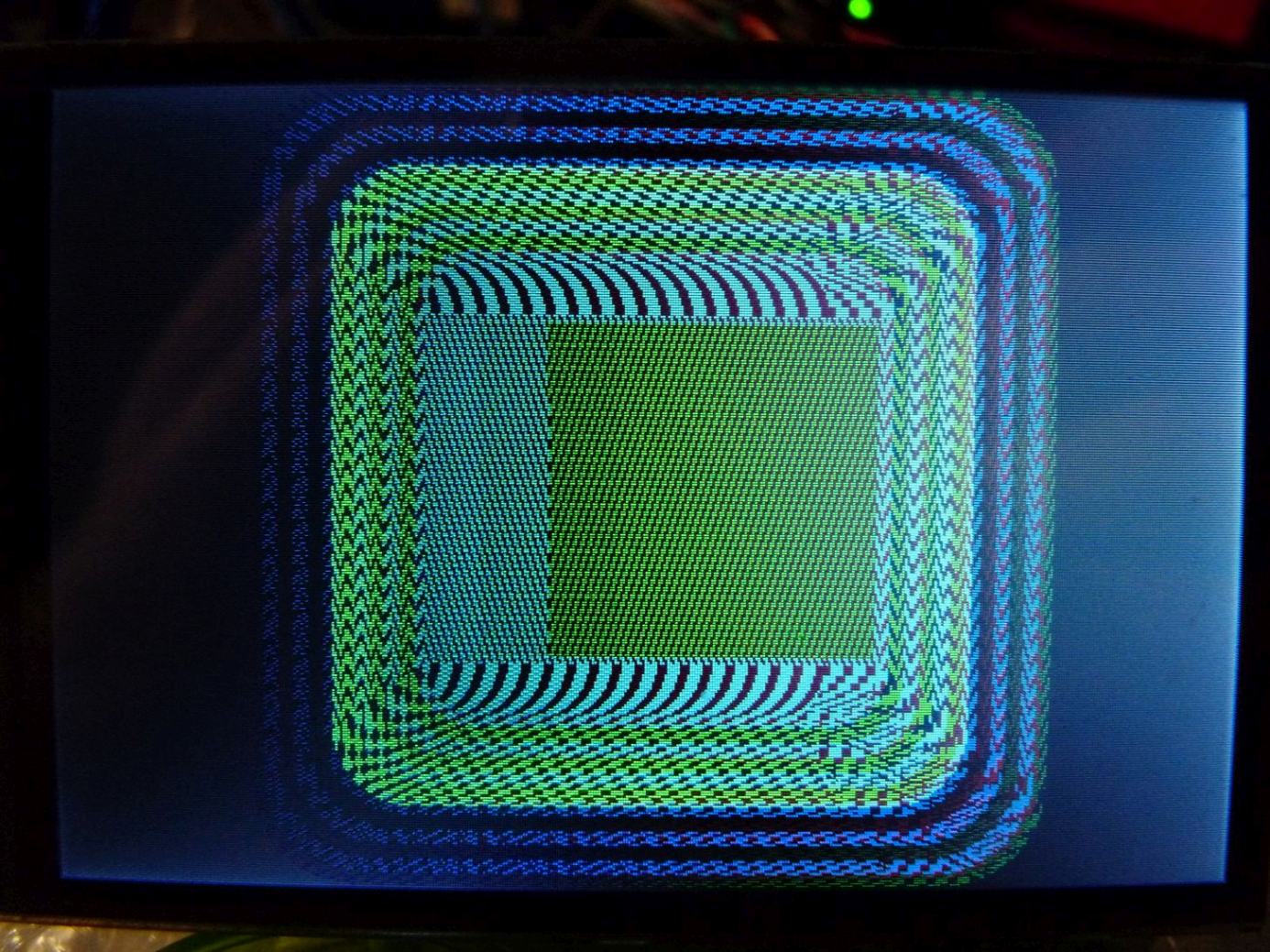

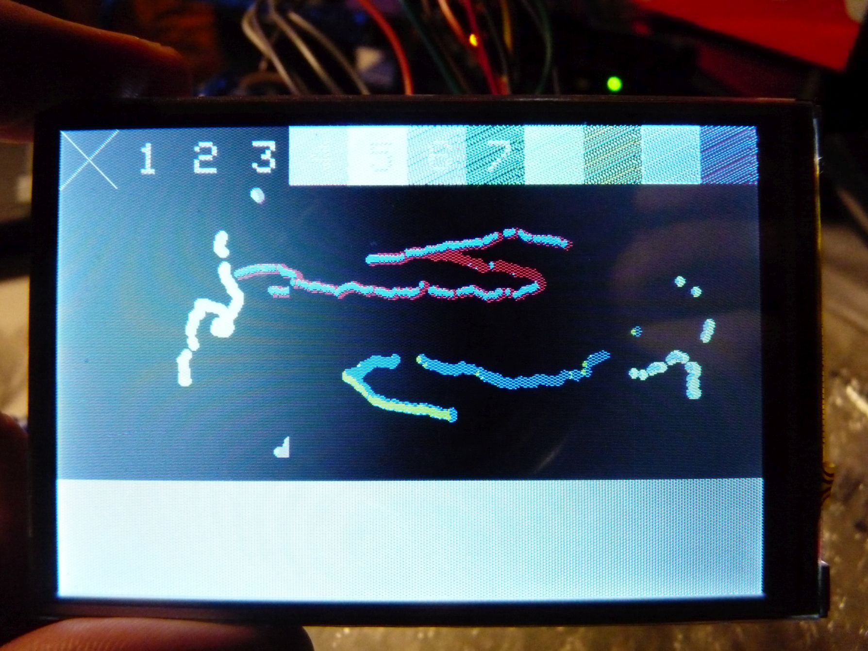

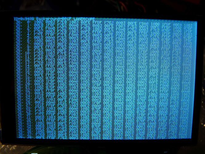

The flickering is gone if I use UTFT or UTFTGLUE. I attach some photos of the tftpaint2, graphictest_kbv and readpixel_kbv sketches.
Do you have any idea about the cause?
The other pics.

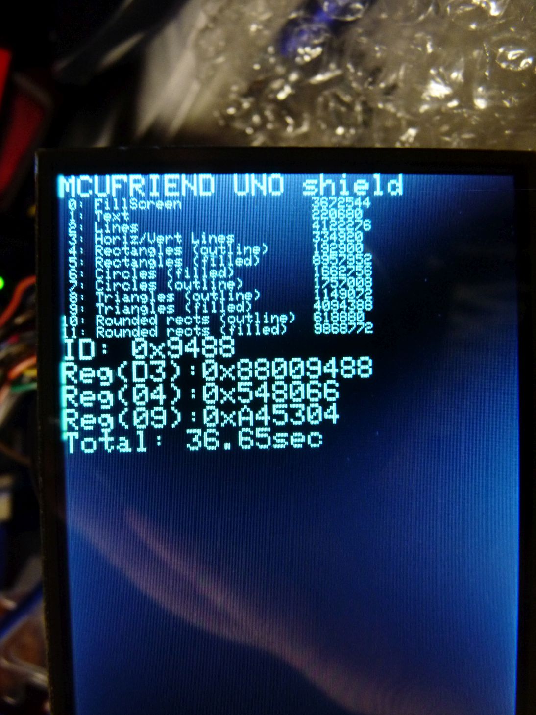

Please can you run the read_ID sketch.
Your readpixel is reading 16-bit pixels instead of the 24-bit RGB that my 9488 and 9341 require. See the previous posts about a ILI9486 Shield that requires invertDisplay() to render the correct colours and also reads 16-bit colour.
I just looked at the photos in the Ebay link. It looks more like 240x400 display than a 320x480. Does your shield match the photos in every way?
I would believe the result from read_ID more than anything written on Ebay.
Your JPEGs definitely show a 320x480.
David.
It says:
Read Registers on MCUFRIEND UNO shield
controllers either read as single 16-bit
e.g. the ID is at readReg(0)
or as a sequence of 8-bit values
in special locations (first is dummy)
reg(0x0000) 00 00	ILI9320, ILI9325, ILI9335, ...
reg(0x0004) 00 54 80 66	Manufacturer ID
reg(0x00BF) 00 00 00 00 00 00	ILI9481
reg(0x00D0) 00 00	HX8357
reg(0x00D3) 00 00 94 88	ILI9341, ILI9488
reg(0x00EF) 00 00 00 00 00 00	ILI9327
Is this what you asked for?
It doesn't match in everything with the advertisment. Mine has the touchscreen wires on the left hand side and ECW03507 writing on the right. The pinout on the back is the same, but the texts are upside down and the layout is a bit different. It's also 3.5" instead of 3.6".
Yes, you have the correct ID for a ILI9488. And since your colours are inverted, you need to change that.

Now it works! I tried changing the inversion, but the stripes were still there, so I experimented with the color depth settings. Setting it to 18 bit/pixel solved everything. Thank you for the tip and help, it would have taken much longer to figure it out myself :slight_smile:
I am intrigued. Are you talking about UTFT initlcd.c for an ILI9488 or MCUFRIEND_kbv initialisation?
Please can you post the 10 lines of code that you have changed.
David.

I edited only 1 line in MCUFRIEND_kbv.cpp, here:
   case 0x9488:
        _lcd_capable = AUTO_READINC | TWO_PARM_WINDOW | MV_AXIS;
        static const uint8_t ILI9488_regValues[] PROGMEM = {
            0x01, 0,            //Soft Reset
            0x28, 0,            //Display Off
            0xC0, 2, 0x0E, 0x0E,        //Power Control 1 [0E 0E]
            0xC1, 1, 0x43,      //Power Control 2 [43]
            0xC5, 4, 0x00, 0x40, 0x00, 0x40,    //VCOM  Control 1 [0x00400040]
            //      0xC6, 2, 0xC0, 0x00,       //VCOM  Control 2 [E0 01]
            0x36, 1, 0x08,      //Memory Access
            //0x3A, 1, 0x55,      //Interlace Pixel
	    0x3A, 1, 0x36,		//this line was modified
That is really weird. I am not at my PC. I will have to check the data sheet for that register.
David.
Edit. Just looked. reg(0x3A) = 0x36 means DPI=3 and DBI=6. i.e. DPI is reserved and DBI is 18-bits
I had 0x55 i.e. DPI is 16bit and DBI is 16-bit.
On an ILI9486, everything is reserved apart from 16-bit or 18-bit e.g. 0x55 or 0x66.
