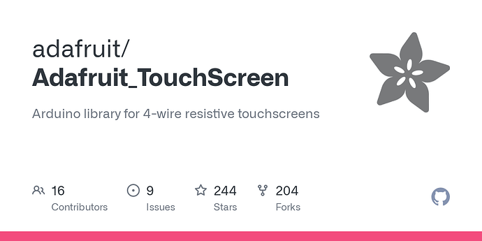

I downloaded this Adafruit GFX Library I found:
and this touch screen library:
and MCUFRIEND kvb from this place , forum, your topic:
