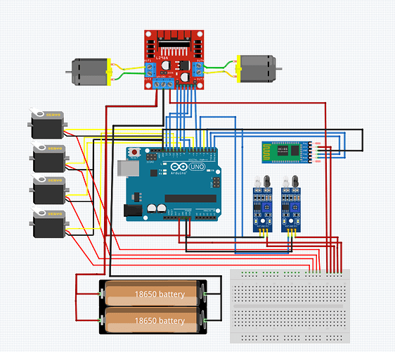

I'm making a Line follower with a robotic arm, the arm moves but the motors don't move
So Basically i have been working on a project, i have to make a robotic arm which is connected to a line follower, i tested the line follower first and it worked, after that i tested the arm and it worked, but when i test them both only the arm move.
I'm using:
Arduino Uno, 2 infrared FC-51, L298N Motor driver, 2 Dc Motors, HC-05 bluetooth Module, 4 servos SG90, 2 Batteries 3,7V (7,4V in total)
i tried to visualize what's happening in seriel monitor and it seems to work but the motors still don't move, i'm thinking that the problem is a powering problem ?

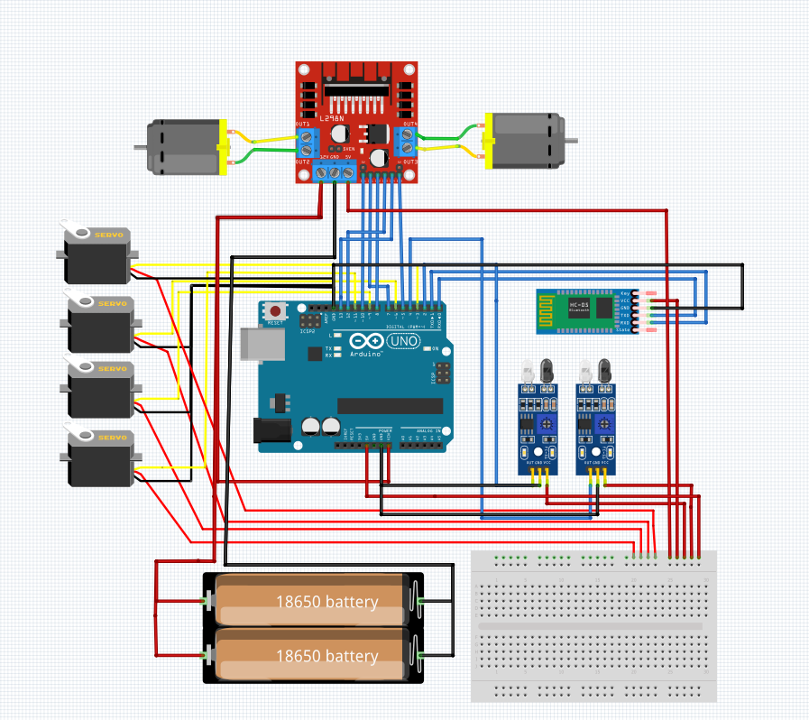

Can you show a schematic of how you have things connected?
Sure ! This is the shematic of the full circuit
I think you forgot to common the grounds. Not sure, hard for these old eyes to see.
One mistake is that you have the batteries connected in parallel NOT series
When using the servo library you cannot use pins 9 or 10 for PWM output.
Use pin 11 for enA and pin 10 for myservo4
