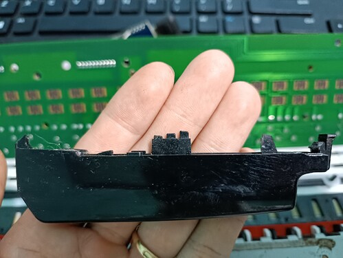

we have to botton in one note of piano, when i put the key down, we will get two deffrent time, the problem is two keboad have to had the same row pin

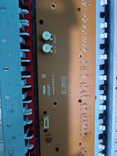

On the underside of that keyboard with all the wires coming out, are those components diodes ?
If you are going to arrange the keys in a matrix and you want to press multiple keys simultaneously, then there has to be diodes in the circuit. However, then you must then connect these correctly. See What is the actual circuitry of a keypad and the switch - #2 by LarryD
yes, those are diodes. I'm using this keboad whithout velocity, so i'm trying to make one with velocity, hope that you can help me check code and fix if you can.
Show (a) the code which you are using for the non-velocity version and (b) a wiring diagram of how you think those keys on the keyboard are organised/interconnected including the diodes.
Your picture appears to show two Nanos (or similar size devices) connected to a wiring "loom". Can you also explain that.

Now you want to extend it to all piano 61 keys on the Yamaha keyboard.
Q1. Is that correct ?
You have shown this picture.
Q2. Is this the Yamaha keyboard ?
Q3. What are the 2 small blue circuit boards connected to the wiring ?
Q4. You have shown pictures of the tactile buttons behind the keys but these pictures appear to have been taken from MIDI keyboard with velocity sensitivity (PASSIVE version) - #10 by petelms . Is your keyboard identical to the one in that thread ?
Q5. Did you get the contents of post #18 from a web search or ChatGPT like tool ?

2, yes, it is yamaha keyboad
3, two small blue circuit boards connected to the wiring are arduino pro micro
4, this is picture of my keyboard:
it work like the toppic i show you, 2 button is not press at a same time, because one button is higher than other,
