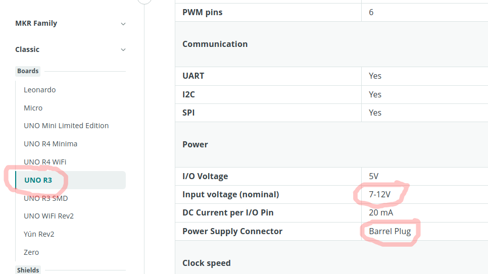

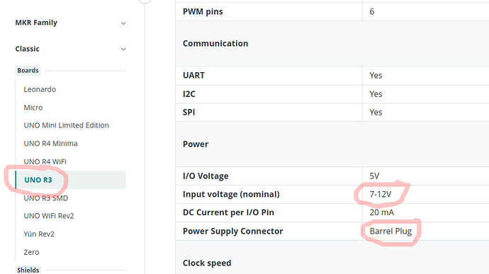

If you are referring to the barrel plug connector, and if you are referring to an Arduino Uno R3, by applying 16V to that connector, you have exceeded the allowable voltage for that input.
As stated in many, many places, beginning with the official Arduino Uno R3 documentation, the allowable voltage input for the barrel plug connector is 7-12 volts.

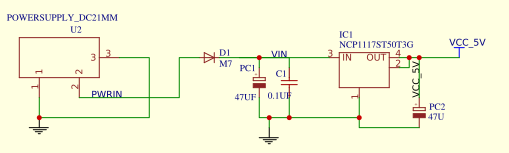

Well the picture looks like this:
Looks to me like the 5.0 Volt regulator on an Arduino Uno Rev 3 or Mega board powers the Arduino as well as anything and everything 5.0 volts including anything connected to the boards 5.0 volts. The connector on the left in the image is the barrel connector.

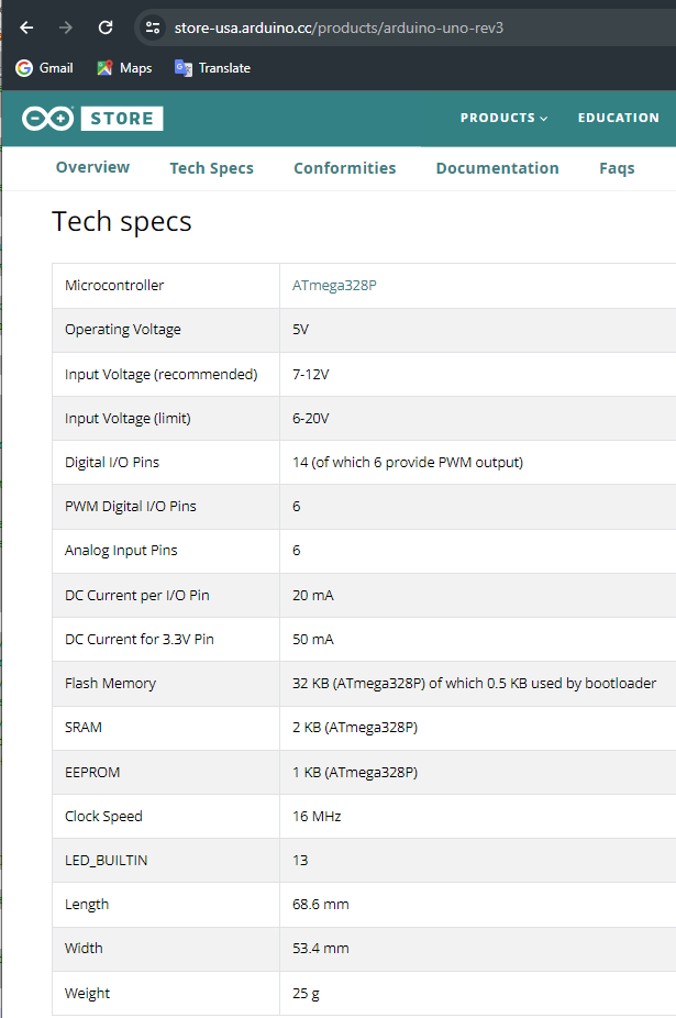

From Arduino Uno Rev3 — Arduino Online Shop
Yes, I know there is a difference between 'recommended' and 'limit' ![]()
I'll believe the engineers rather than the marketing people every single time.
Besides... that's for an official R3. Care to place a wager on the OP having a 3rd party board with components with lower voltage ratings being used?
