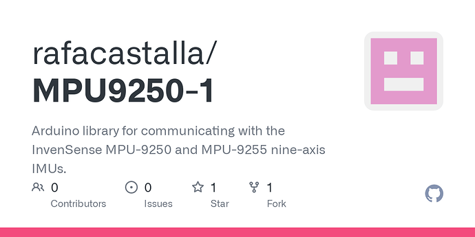

Which library are you using for the IMU? I have not found the correct one yet, so can't compile the code.
A few things I notice in the code you posted:
In setup, there are calls to begin() for the IMUs before you call the functions to select the multiplexer channels.
In loop, you have a call to the function to select the multiplexer channel for the IMU you want to read, but do not have anything to de-select the channel on the other multiplexer. That leaves both IMUs connected to the SPI bus at the same time.
The last tcaselect() function that you have commented out looks like it would work properly to de-select all the unwanted multiplexer channels over a 16-IMU system.
sorry i can't upload the file. i attached the link of the library for reference purpose.
