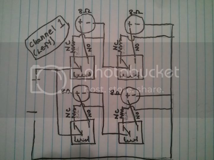

A friend of mine had a sugestion that's sounded good. He suggested using 4 relays with NO and NC contacts. Put an 8 ohm resistor on the NC contact and connect all the relays in a parralel series such that I end up with 8 ohms total impedance. Then on the other contact, connect the speaker. This way, when I de-energize the relay it cancels out the speaker and flows through the resistor. Energize the relay and the resistor is removed from the circuit. That way I will always have 8 ohms total impedance.

Got my speaker selector from monoprice today. After opening it up and looking at it, I'm even more confident that I can build my own. This one would be too hard to hack. They use DPDT switches instead of DPDT relays. This would make it hard to tap into. The way this one works is simple. There are two circuits. Each one has the grounds ties together and places 5 ohms across the + line in, into a bus connected to 4 switches which will then go out to the speakers, essentially putting all 4 speakers in parallel. This will give you 11 ohms with one speaker on, all the way down to 7 ohms with all 4 on. There is also a switch to bypass the resistors if you don't wish to use the impedance protection.
Which method sounds better, the one above except relays instead of switches or the following...
Either way I'll connect the relays to some transistors to be controlled by my Arduino and a max232 chip.
After some additional thought, I don't think that I want to use resistors for this because of the power that they consume and the voltage drop into the speaker. Looking at some other commercially available devices that do things similar, it appears that the higher end devices use transformers rather than resistors. I have a general idea how this might work. Does anyone have any insight into this?
