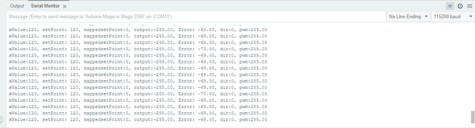

In the Wokwi simulator I tried to look at what your code was doiing and made some changes:
// https://wokwi.com/projects/380882887246419969
// for https://forum.arduino.cc/t/implementing-pid-control-using-timerone-library/1179916/29

void report(void) {
  static unsigned long last = 0;
  const unsigned long interval = 500;
  unsigned long now = millis();
  if (now - last < interval) return;
  last = now;
  //   Serial.print(now);
  //   Serial.print("ms");
  Serial.print("xValue:");

Yes sorry for not being too specific. I tried your actual code in my hardware system, motor with encoder,but as soon as I switch on the system the motor achieves full speed no matter in what direction I move the joystick, it doesn't influence the pwm and motor keeps rotating at max speed, according to the report, i can see the xValue update according to the joystick... Everything updates except for pwm value and direction,unable to control the motor
What does the error do? If there's some sign wrong somewhere max speed might be going the wrong way making the error larger.
So I tested again after modifying the PID values, Since you changed the pwm from -255-255, the current PID values were taking too much time reach set point, so after modification now I'm able to control the change in direction but I can't control the speed as desired. For example if i move the joystick half way forward and let it go, the joystick value becomes 119-121 the idle value but the pwm keeps on increasing until it reaches 255
And samething happens if I pull the joystick backwards, this time it drops the value from +255 to -255(but - sign cant be seen as abs() is used) again but in reverse direction.
So I'm able to control the direction, but the the motor just accelerates towards the direction of the joystick untill it reaches max speed(pwm=255) and remains there until the direction is changed either from 0 to 1 or vice-versa. Can't maintain a constant speed, So with the current program the speed will be either 255 or -255.
Here's a snapshot of the report when the joystick was moved and let go, the joystick value returned to normal but pwm kept rising till 255 and remained there. And the error also remains the same at 255 pwm.
From the report, it looks like error is constant around -69 and output is constant -255, which maps to dir=0 and pwm=255.
Based on your report numbers, I think there's a sign error somewhere. If the mappedSetPoint = 0, the output is -255 and the error = -69, then RPM1 must be 69, and this bit:
...should be incrementing by -69.0*elapsedTime /1000 = -17 each time, and reducing the output by -17*0.6=-10.2 Seems like a sign/dirPin/Polarity/direction error somewhere.

Oh, your encoder is counting only pulses and not direction, so it doesn't give +/-RPM. with the sign changing when it spins forwards or reverse. That will cause a problem at the discontinuity when either the motor or the setpoint switches direction-- maybe assume the RPM direction matches the dirPin?
And also, because of
then
...does not return a float into RPM1, it just sets the global int RPM1 as an integer. Since counter is a 'double', it looks like it will do the math in double, so it shouldn't fail with integer math truncation like (95/96)*240 = 0
