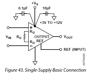

Edit: do you have the amplifier properly decoupled? If not, it is probably oscillating at the high gain settings. See Figure 43 of the AD623 data sheet (attached). Those capacitors should be as close the the amplifier chip as possible.
Yes, I am using the capacitors for decoupling. On this test circuit I am using the 3.3v and 5v outputs from an Arduino which do share a common ground.
That the effect depends on gain suggests that the amp could be oscillating, despite the decoupling. Have you checked the output with a scope?
If this circuit is built on a plug-in breadboard, note that they are notorious for problems with grounding and stray capacitance. See the section in the data sheet on good grounding and circuit board construction practices.
