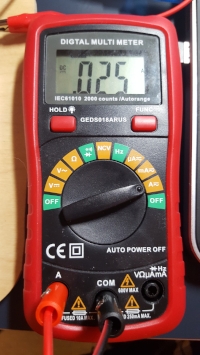

Current measurement can be tricky... Even with a DMM it's tricky because you have to break the circuit to insert the meter.

I trying to analize arduino power consumption. I have been using a multimeter (Fluke 17B+) to measure the current consumed by an Arduino UNO (20~50mA). To do that I followed this tutorial:
Now, I want to substitute the multimeter with other Arduino. I'm want to do that so I can log the results and, maybe, plot a graph.
