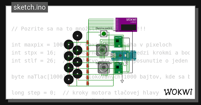

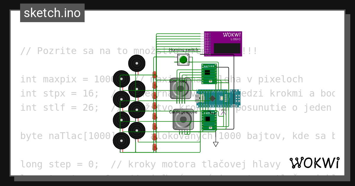

Here is the link to the Wokwi page:
What are the fixes that I could put into it other than abstraction, abstraction, code simplification, and any other form of code shortening or untangling?

What needs to be fixed is the behavior of the pins (pins that should not strike are seen firing, as if they received an alternating pattern of turn on and turn off). Run the thing, feed it 50 groups of 20 letters, and use Pulseview to look at the .vcd file the logic analyzer generates

Here it is
