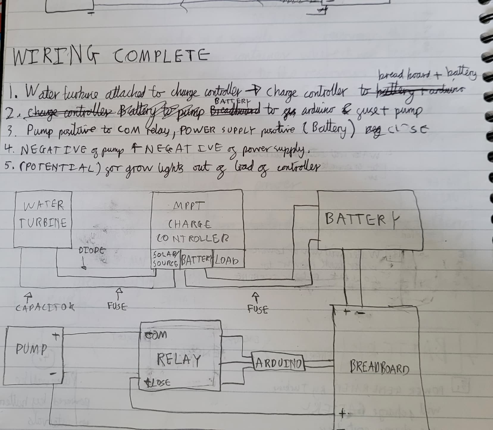

In theory should this wiring work
Will this wiring work?
I wanted to charge the battery while also being used in intervals.
That is correct. Every MPPT-based Solar, Hydro, or Wind system looks like this, except that most will have an Inverter where the breadboard is to provide AC.
The only thing I would change is to replace the breadboard with more robust connectors. I used Marine Bus Bars.

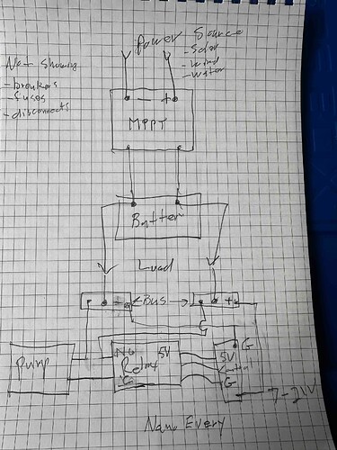

  • Let’s see a real proposed schematic now.
I just noticed you appear to be powering the relay coil from the Arduino. That is not a good idea, power the coil from the battery so only one digital control wire and Ground between Arduino and Relay coil.
I am sorry but I don't really know how to do that, I drew it like this for my own personal understanding
are u able to do a basic sketch to show what you mean?
Is there any precaution I have to take or a certain way I have t wire it to use the battery while it is charging or is diagram ok?
how would I wire the battery to the breadboard/ connector if both terminals are connected to the mppt controller

The simple answer is the MPPT is charging the battery. At the same time the Battery is providing power to the Pump (conditionally) you could also use that battery to provide the relay coil power or use the pins as you have.

Here is my poor drawing. I think it is the same as yours, except get rid of the breadboard. If this is going to be outside of conditioned space, use Marine Grade Bus Bars, breakers, disconnects and use double-walled heat shrink with maximum overlap on all connections. They contain glue as they must be air-tight to stop corrosion. Also, any bolts or other connectors should be coated with galvanized coating (marine grade)
The NANO EVERY is crucial as it allows VIN to be from 7V to 21V. There may be other boards that allow more than 14.8VDC, but I didn't search for any.
I don't see a programming interface for setting the battery charging parameters. What is your thinking there?
What MPPT are you planning to use, does it have settings for LiFePO4? Perhaps a link to it would be best. I strongly recommend Victron.

I assume you have done an energy audit so you know how much power your location can provide per day. I see it is a water turbine! That is the most reliable so you can likely get away with something quite small in an MPPT.
Does you battery have 4 separate wires like you show?
Your load (arduino/pump) should be connected to the Load output on the MPPT. Make sense?
