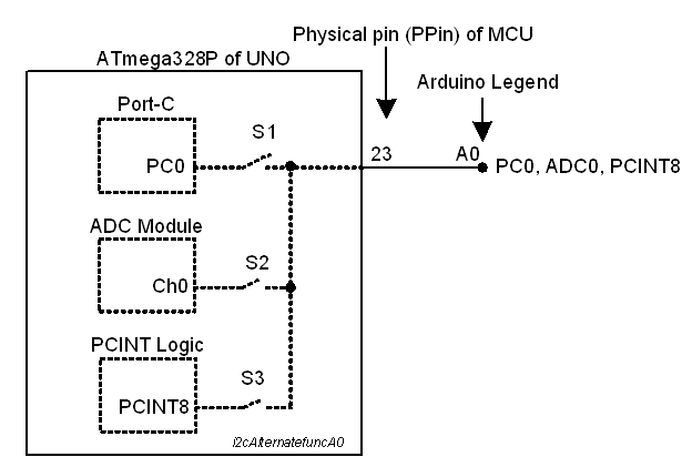

1. A0, A1, A2, A3, A4, A5 are just printed legends near the edge connector of the Arduino UNO Board. They are uttered, by many of the users, as A0-pin, A1-pin etc.
2. The A0-pin is connected by PCB track with PPin-23 (Physical Pin-23, Fig-1) of ATmega328P MCU of the UNO Board. PPin-23 is associated with following signals which come into action one at a time.
PC0(ADC0/PCINT8)
Figure-1:
3. By default, PPin-23 is a digital IO line. It will send 1-bit data to outside device or will receive 1-bit data from outside device. At this time, the name PC0 (Bit-0 of Port-C Register) has been given to PPin-23 in the data sheets (Fig-2).
4. In Arduino IDE Programming environment, the digital IO pin of Step-3 has been given the name A0/14 which the Smart Compiler maps into appropriate assembly/machine codes that are suitable suitable for the MCU to execute. The following codes are valid:
pinMode(A0, INPUT);
int pinValue = digitalRead(A0);
5. PPin-23 gets connected with Ch-0 of the internal ADC of the MCU when the following code is included in the sketch. At this time, the name ADC0(Ch-0 of ADC) has been given to PPin-23 in the data sheets (Fig-2).
bitSet(ADCSRA, ADEN);
Now the PPin-23 acquires analog signal from an external sensor whose output is connected with A0-pin of the edge connector. The following codes are valid in the IDE programming Env.
int y = analogRead(A0);  //
6. PPin-23 gets connected with Pin Change Interrupt Logic of the MCU when the following code is included in the sketch. At this time, the name PCINT8 (Pin Change Interrupt of Type-8) has been given to PPin-23 in the data sheets (Fig-2).
bitSet(PCICR, PCIE1);
Now the PPin-23 detects any logic level change on it imposed by an external device and then enters into the relevant Interrupt Sub Routine.
7. The following diagram (Fig-2) is an attempt to present the alternate functions of PPin-23 of the ATmega328P MCU.
