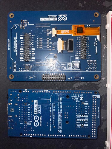

I'm not currently using anything other than the base Arduino Giga and it's display shield. Looking here, I'm unable to see any glaring issues or faults in their wiring. (Both of the front sides look exactly the same as advertised)
Furthermore, the only notable thing I've noticed is that the orange flex cables have released from their seated position - though that is if they were seated in the first place.
Hi @bheitz780.
By "seated", do you mean the cables being attached to the PCB along their length (rather than only by the connections at each end of the cable? If so, then no there was never an attachment to the PCB along the length of the cable.
