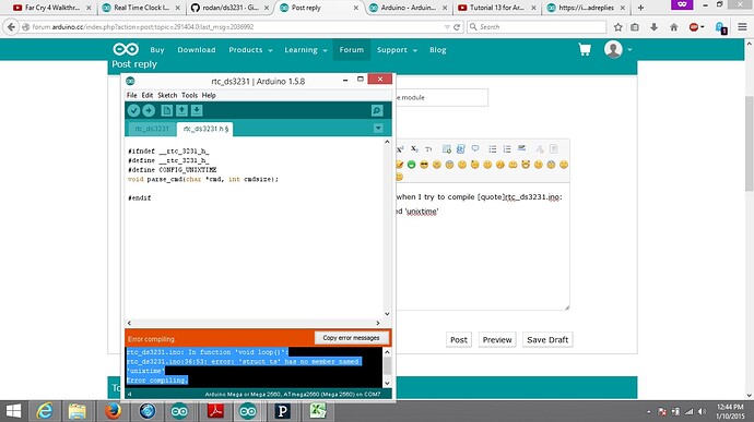

I get the following error when I try to compile
rtc_ds3231.ino: In function 'void loop()':
rtc_ds3231.ino:36:53: error: 'struct ts' has no member named 'unixtime'
Error compiling.
The attachment shows how I edited the .h file. Did I do this correctly? I've never messed with a side program within the same sketch before like this .h file is.
Looks OK to me. Now, you need to post links to all the libraries you are using, so we can look at the code.
Library links for all the code used in the example. The example I am using is one of the three examples that comes with the library labeled rtc_ds3231
It looks like the #define CONFIG_UNIXTIME is in a file called config.h in the ds3231 library.
Where does this go in the code? In the main code up top, or in the secondary DS3231.h folder?

I would go to the config.h file and remove the comment // lines from in front of the //#define CONFIG_UNIXTIME.

#ifndef _config_h
#define _config_h
// comment this out if you need unixtime support
// this will add about 324bytes to your firmware
#endif

What I am not understanding is how do I get to the config.h file? Is this in the sketch below? I swear i've looked many times. Or is this file somewhere in my computer?
The ds3231 library is installed on your computer. If you are using windows, it should be in a path like this
C:\Users\you\Documents\Arduino\libraries. This users library folder will be in the same folder as your saved sketches. It is not the libraries folder in the program files(x86) where the IDE resides.
Find the ds3231 library and open the folder. You should see all the components of the library including a file called config.h. Open that with wordpad or another text editor and modify the //#define CONFIG_UNIXTIME statement to remove the comments. Save the modified file. Restart the IDE.
Just to be clear about exactly what I should remove.
Before
#ifndef _config_h
#define _config_h
#endif
After:
#ifndef _config_h
#define _config_h
// #define CONFIG_UNIXTIME
#endif
Is this right?
Is this right?
No. The written comments are confusing. It can only mean "remove the comment marks from the #define if you need unixtime sujpport."
#ifndef __config_h_
#define __config_h_
#endif

However, When After I load this it says the time is
RTC has set the system time
1:05:23 1 1 2066

Your first Void setup() sniplet resulted in the serial monitoring being correct, but then when I loaded the sketch that was designed to read the time dirrectly from the RTC the serial monitor showed
GET time
1915.01.15 04:16:28 0
1915.01.15 04:16:33 0
1915.01.15 04:16:38 0
1915.01.15 04:16:43 0
1915.01.15 04:16:48 0
1915.01.15 04:16:53 0
which is strange because the last zero is the UNIX time. Shouldn't it be changing with the time?
I did as you suggested, but am unsure if this is where it should go. The results were the same
