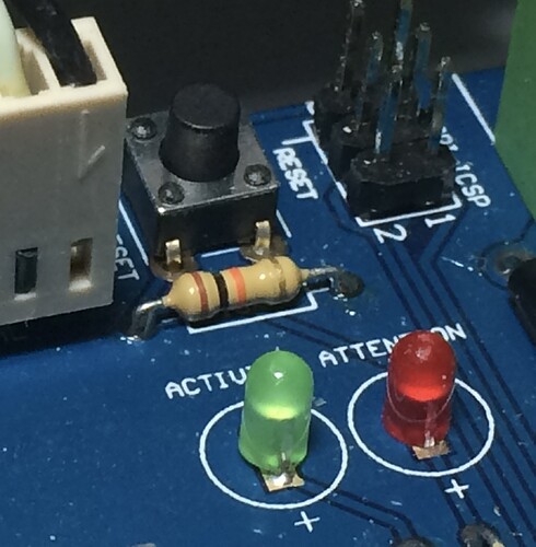

A perfect example to answer your question.
ACTIVITY blinks every 700ms, ATTENTION lights if a pefsistent error has occurred
If that’s your PCB design, curious to see the whole board ?
