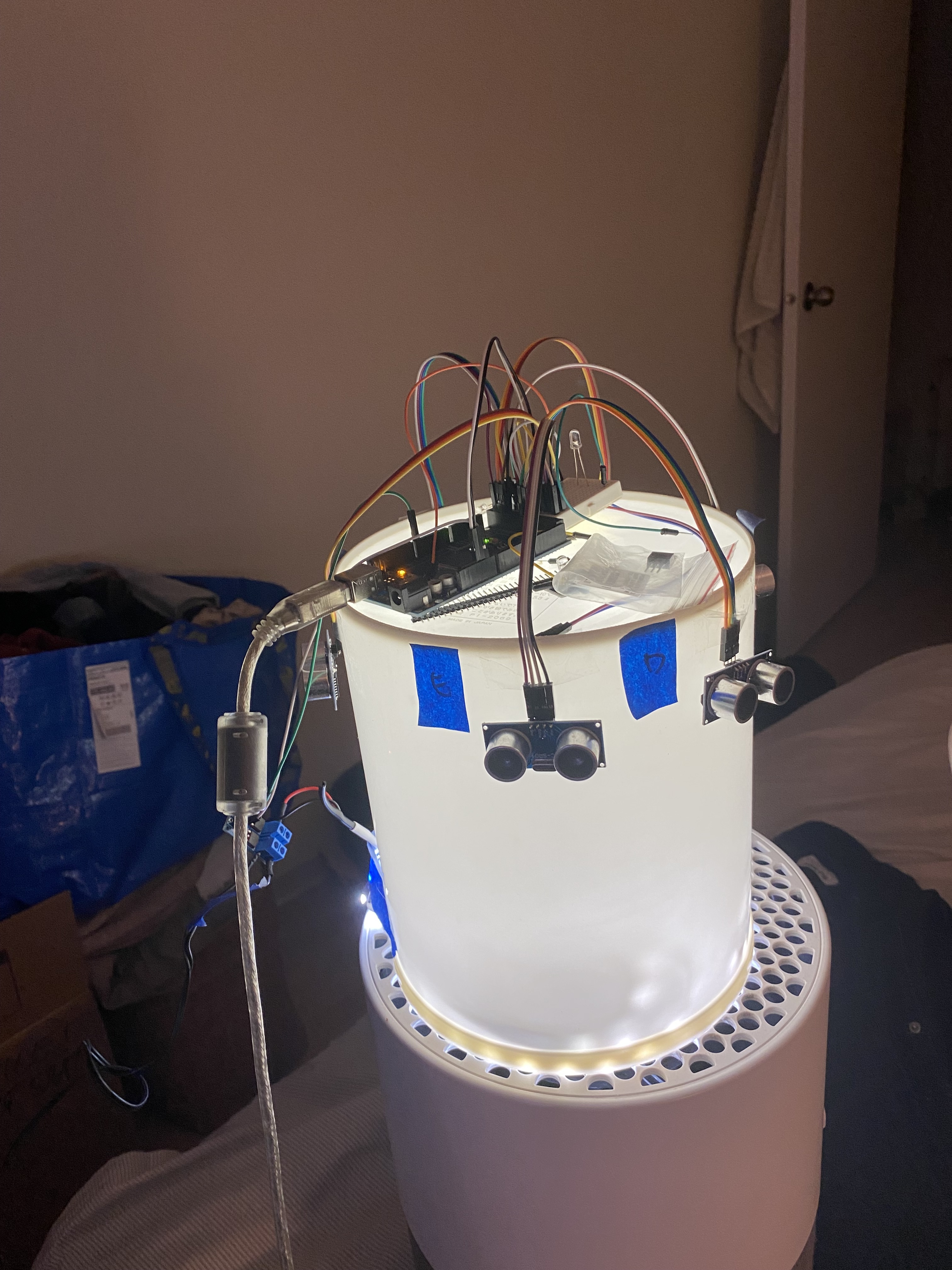

They are placed 360 around an object.. the intention is to brighten as more people (6) gather around the object, like a fire or idea or dinner table.

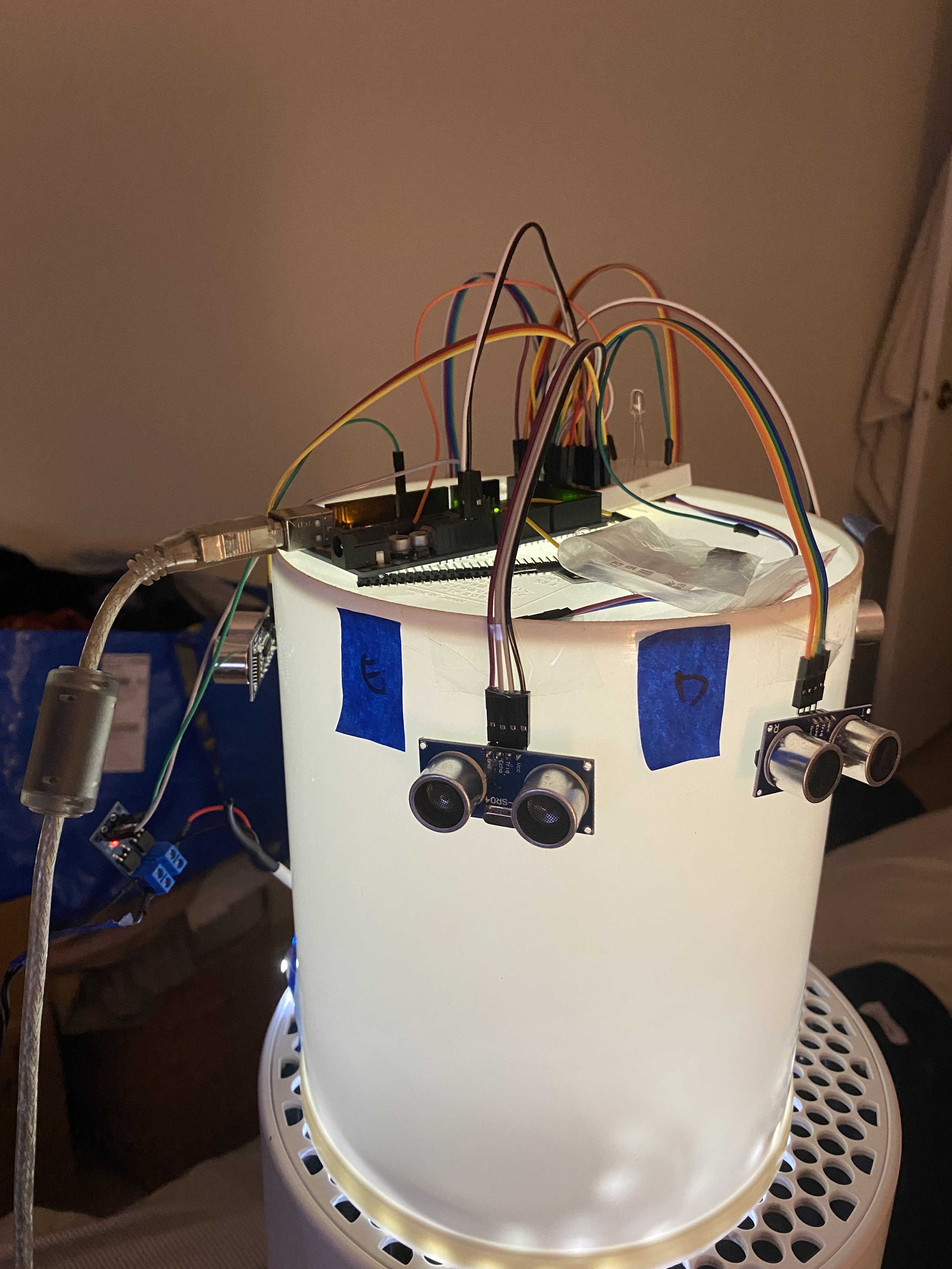

What you have shown of your project in your pictures is fine for a prototype. But before it goes into an exhibition it will need soldering up on strip board and removing the solderless bread board otherwise your project will be unstable in the long term.
I also noticed a wire coming from an LED and not being connected to anything. Have you remembered that an LED needs to have a current limiting resistor in series with it to avoided damage to the LED and Arduino?.

Haha, thanks yes we will be soldering up a few sheilds for the MEGA board to make assembly easier, (we are makeing 6 of these for the peice)
And thanks for noticing! the little LED was a tester before I had the MOSFET module to drive the strip of lights in the garbage can!
