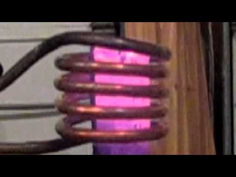

I have finished an induction heater tutorial, using the atmega328 and programmed with the Arduino duemilanove. Please comment on the tutorial if you like.
The tutorial: http://inductionheater.com
and a cool video showing one of the things it can do
Here is a video showing how it can be used to heat a billet of steel for forging

imsmooth posted the wrong link. His videos refer to http://inductionheatertutorial.com
He also used the atmega328 "programmed with the Arduino duemilanove" so how can it not be Arduino related?.

I wondered how the Arduino was involved, and it wasn't immediately clear. It's controlling the levitation - I was just skimming the tutorial, though, so I don't understand the details of it. (The induction heating itself, I think, does not require a microcontroller.)
@imsmooth: Impressive - floating molten metal! (I admit I'm approaching it just from a coolness-factor stance.) A table of contents at the beginning of the tutorial might be handy.
