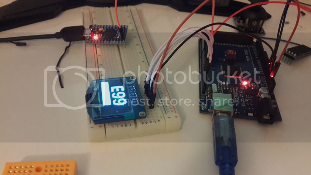

Hiya! Its been 3 days with Arduino & C++ and first post here so excuse me please for any non-sense. thankkss!
I'm trying to read the ethanol sensor values on my OLED screen but no go.
  • The sensor outputs 0-5v which means %0 alcohol for 0.1 volts and %100 alcohol for 5.0 volts.
  • The sensor also sends PWM signals(over same output) which means 1 hertz 1 Celsius degree and 100 hertz means 100 Celsius degree.
So I put this into 2 stage. First reading voltage. Second, reading in hertz.
After experimenting with some libraries I came to here;Failed in both!
The problem is here, I start experimenting with a rotary switch and now I can't translate it to 0-5v and tearing up my hairs.
Here is the code;

The problem here if i modify the code;
vol_val = 5.0 / 1023.0 * (analogRead (VOL) + 0.5) ;
the
u8g.drawBox(0, 44, val, 22);
turns with nothing. The gauge bar doesn't work. I'm also checking val over the serial port screen and it reads 0 or absurd values.(checking with aa size battery)
Could someone guide me to solve the problem.

i don't see any place in your code where you tried to debug the problem by using Serial.println, etc.
Paul
Okay I missed the whole idea and reworked on the code.
The sensor outputs frequency 50hz to 150hz to show ethanol content %0 to %100.(not voltage)
It works!
Here is the code for whom want to build their own gauge for their cars.
Now I need to calculate the duty cycle since the duty cycle shows the fuel temperature . The code below only shows ethanol percentage.

Anyone have any idea how can i add a digit to my code?
54 hz for E4
55 hz for E5
so 54.3 hz should be E4.3
Can I do that?
