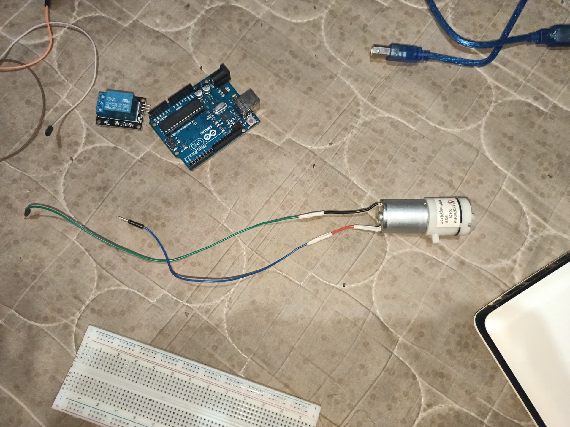

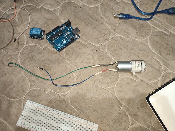

I need help for my project my project is a pump like inflating mechanism and my pump seems to have a problem I can't power it I dunno if the problem is lack of voltage to it and I'm trying to do like this video https://youtu.be/TTSoW_D70y0?feature=shared please help me build like that

The Arduino is not designed to be used as a power supply and certainly not for powering motors. It cannot deliver the required current and could easily be damaged
What you need to do is to power the motor from an external power supply such as a suitable battery such as 4 AA cells in series or a mains power supply
To help you we need to know what sketch you are running, what it should do and how all of the project components are connected
What is your power source?
Does the pump run when directly connected to this power source?

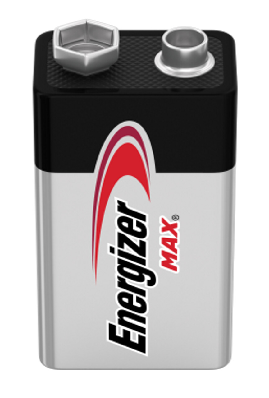

That is my problem I'm a beginner in making with these what should you recommend I use a 9V battery?
If it is a PP3 like this
Then it will not last long powering an electric motor because it cannot supply the required power even for just the Uno, let alone an electric motor
4 AA cells in series will be better
