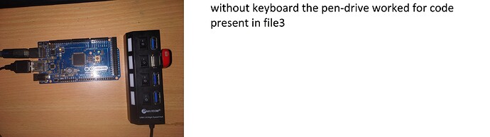

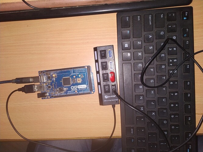

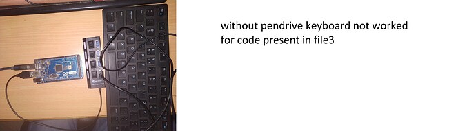

hi sir am working a project on usb hub...
  1. when am connecting keyboard to arduino through usb-hub then it works for file-1
  2. when am connecting pen-drive to arduino through usb-hub then it works for file-2
  3. when am connecting both pen-drive and keyboard to arduino through usb-hub then both are works for file-3
  4. when am removing pen-drive and put keyboard to arduino through usb-hub then keyboard not works for file-3
  5. when am removing keyboard and put pen-drive to arduino through usb-hub then pen-drive works for file-3
You only describe what does and does not work with your current code. I have no real idea of what you want to improve.
If the pen drive is not present, don't try to open files on it.
i don't try the pendrive files... even thought keyboard is not working properly
