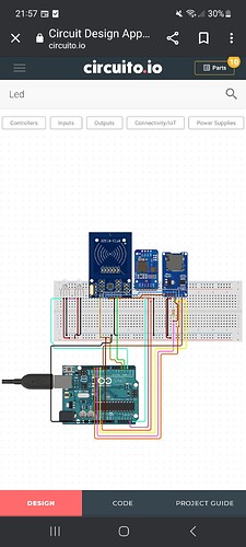

Initializing sd card failed
I checked all my wiring and code and everything is fine but when I run my code i get the message tha initialization of my SD card failed
Can someone help me?

Give me a diagram of the hardware
You have two SPI devices connected. In the past the venerable SD card from eBay and an issue in that it would not tri-state the MISO line. The makes the SD card MISO line not responsive.
To verify, remove the MRFC522 and see if the SD works.

Before trying to debug your own code, make sure that one or more of the examples in the SD library runs as expected. The SD card itself could be a problem, as well as the hardware.
Alright I will go over this and see if there's a problem but if there isn't I'll go run the code in Arduino Create
According to the schematic you have crossed pins 4 and 10.
CS_RFID = 10 not 4
CS_SD = 4 not 10
Name all the modules that you use
I used a RTC DS1307 module, a SD card module and a MFRC522 RFID Reader.
He's right you did cross will that fix it in the schematic form??
